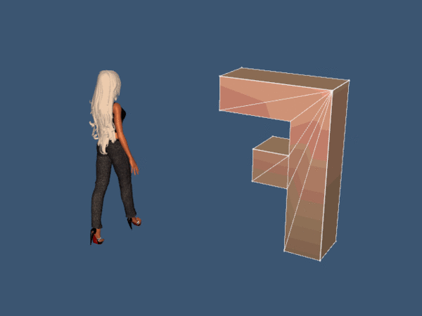

  • mCasualmCasual Posts: 4,604
    edited May 2014
    Friday or Saturday would be a good day to release Beta6
    which will include the "endCap" command that inserts profile shaped caps anywhere along the path
    here, 1 cap at the start of the path and one at the end
    you know when you look at this walk we get the impression the inflection point for the back of Aiko3's thigh is too low

  • RAMWolffRAMWolff Posts: 10,148
    Are those the actual poly's Casual? They look really odd to me. Do they texture well or will a tiling tile look stretched at one end and the other end as it comes together look squished?
    edited May 2014
    the method used to triangulate the polygons is called "ear clipping " it's the simplest but it does produce fine shards, the textures wont have distortions at all . the caps are not welded to the molding, else there would be issues with smoothing.
    http://en.wikipedia.org/wiki/Polygon_triangulation
    Hmmm, that's extremely cool! Wonder if I can make one of those in ZBrush? Your script will create the appropriate UV too then?
    edited May 2014
    zbrush could possibly re-triangulate ( tesselate ) it using methods that produce better triangles
    but as you could see above, this doesnt cause texture layout prblems
    i was also showing that the molding sides and the endCaps can each have a separate materials

    improved robustness of the script
    if an error in detected in your extrusion path script, processing stops, so malformed objects are not created and things like infinite loops are avoided. Note that often Daz Studio crashes when attempting to load malformed objects, so that's an important safety precaution.
    here we avoided problems the first time the script attempted to follow the script's instructions when it was building the preview image.
    then when i tried to actually build the thing
    359 x 491 - 19K
