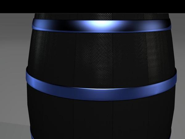

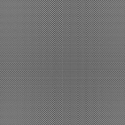

    Here's a home made irregular pattern, not seamless - but you can use it freely.
    600 x 600 - 112K
    1920 x 1003 - 433K
    Post edited by Design Acrobat on
  • edited December 1969
    Thanks for the effort DA
    Its going to be a 120 cm picture of a kayak-paddle so it has to be pretty lifelike.
    Mic

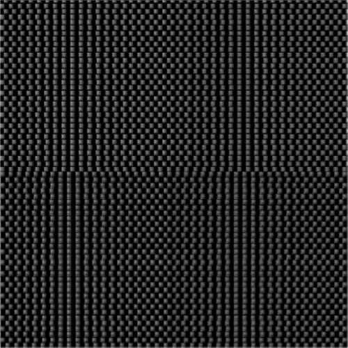

  • VarselVarsel Posts: 574
    Here's one I made in Genetica.
    use it as a mixer in the Colour Channel
    use it in the Highlight Channel
    and use it in the Bump Channel.
    Depending on the size of the object and UV-map layout, you might want to Tile it.
    (It is seamless)
    800 x 600 - 180K
    1024 x 1024 - 807K
    Varsel, would it be possible to share the shader itself?
    ...as I would not know what to do with what you have shared.
    I cant see any weave in the bottom picture.
    Mic

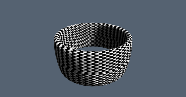

  • 3DAGE3DAGE Posts: 3,311
    Hi Mac Mic :)
    You should be able to create a basic carbon weave,, or fabric,.. by using the Check pattern as Holy mentioned above.
    you can also use the transform options in procedural functions like Fractal noise, to create a directional grain,.
    it's a bit like a pencil cross-hatch shader,,

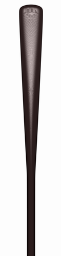

    Here;s a quick example Procedural Shader,. so you can either adjust the parameters to suit the scale of your model,.
    or apply it to a plane and export that out as an OBJ, to use Carrara to convert the Procedural shader, to a Texture map,.
    then you can edit that texture map. etc.
    Shader link
    https://dl.dropbox.com/u/7907045/carbon_chek.cbr
    pic
    800 x 600 - 205K

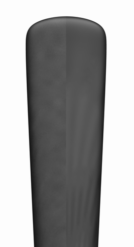

    Heres what I get
    473 x 870 - 63K

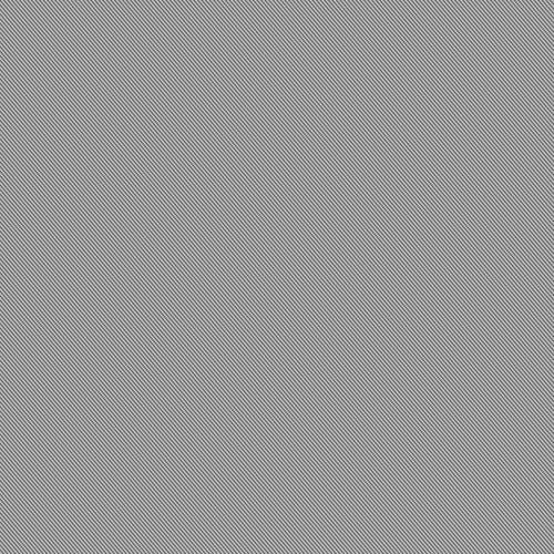

    The first one wasn't weave, but my interpretation of what google showed me it looked like.
    This one is a weave.

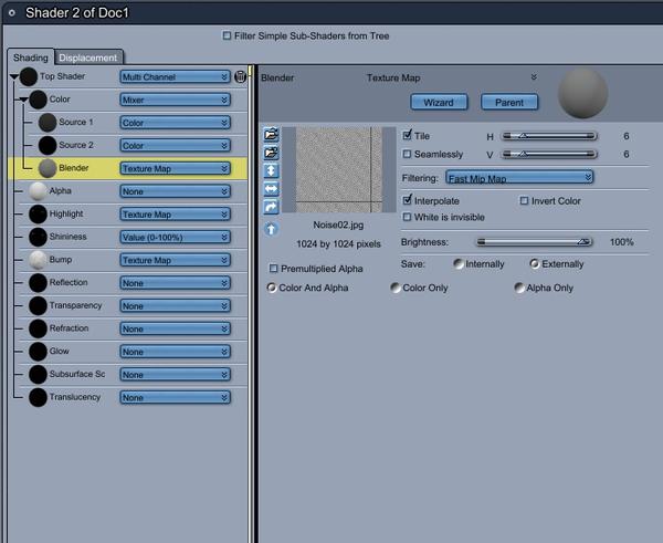

    And this is how I did build up the shader.
    In the color Channel I chose a mixer. One colour as dark grey and the other as black.
    This is just to fake the apperance. (as far as I know Carbon fiber are black).
    In the Highligt channel I used the same map.
    The Shininess is set to 20 %
    And in the Bump Channel I also used the same map.
    The bump value I set to 5 % (this value is set in the top shader)
    The maps are tiled. The Horizontal and Vertical Tile values will depend on the scale of the object and UV-map. Might be a trial and error exercise to get it right.
    696 x 569 - 101K
    1024 x 1024 - 722K
    800 x 600 - 26K

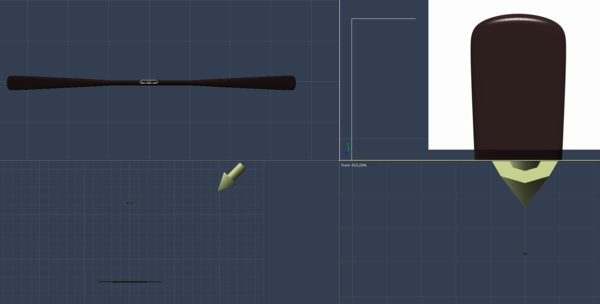

    Thanks Varsel
    What do you do with the blender of the two colors
    As you can see I only get the weave at the hilite at the tip of the paddle
    What can I do about that?
    Mic
    1787 x 904 - 58K
    OK
    I rotated the light and placed one in the other end
    288 x 1212 - 83K
    Ah yes. It's all about lights and mirrors.... magical.
    Lights : The Holy Grail of 3D.
    Cripeman has some tutorials about this. Check the Carrara 8 information at the stickies on top in this forum.
    What you see is the shininess.
    What you can also do is to chose a mixer in the Highlight channel. Use different values in the Source channels and use the texture map as a blender.
    Some adjustments with the bump value might also help.

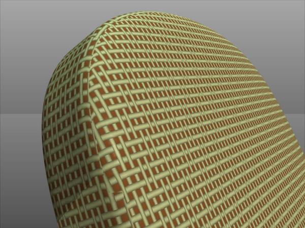

    Just wanted to thank Holly about the heads up on the Veloute Shader. (made by Julien-inagoni). For less than $35.00, what a bargain! :)
    I have a new toy to play with. This is a basic basket weave I created with the Veloute plug-in.
    Sorry, hope I didn't derail the thread - just wanted to thank Holly for her Carrara insight and wisdom. :)

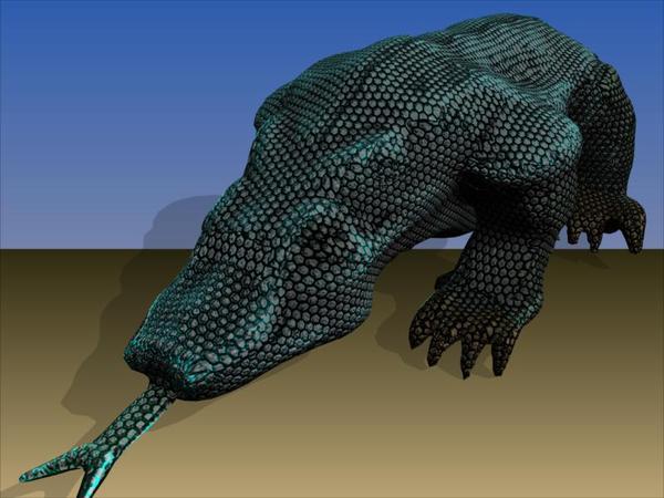

    Thanks for the link! Still having fun with Veloute though. Will check out the plug-ins later.

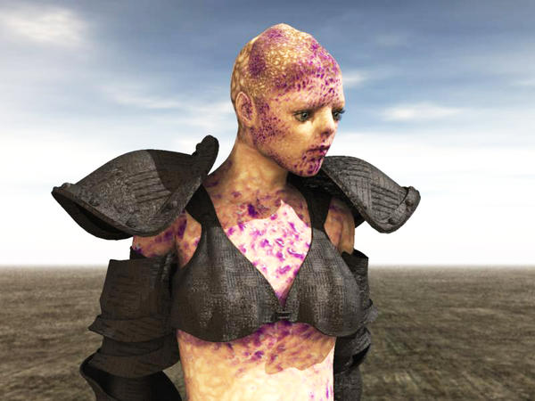

    Here's a Komodo dragon I modeled and put a one layer Veloute on it to simule the rows of scales it has. Kind of like the blue I initially added. heh Probably needs to be mixed with the original texture and light map to get the more realistic view.
    800 x 600 - 62K
