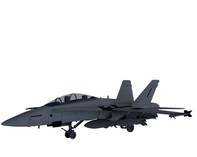

    Finally...found a high enough density model to do some timing runs that are meaningful...
    It's an over 500,000 TRIANGLE (537,404 tris) model.  The shader is one of my own imports.  It's an 'oldschool' shader that is a simple clay shader.  Lighting is an environmental light shader (no, not UberEnv, but Kettu's one).
    In 'standard'/REYES/old school mode:Total Rendering Time: 10 minutes 29.81 seconds
    In 'Progressive'/raytrace/'new' mode: Total Rendering Time: 50.41 seconds  <<<< That's right, under 1 minute!
    Using the raytrace mode, with caching enabled, by way of scripted rendering: Total Rendering Time: 22.40 seconds  <<<Yep, half the time than without caching.
    Iray: Total Rendering Time: 4 minutes 1.9 seconds
    All renders are using the same 4 core AMD CPU and 8 GB of RAM system, Iray is running in CPU only.

    Okay, I think you're saying that all that is needed for 3DL in DAZ Studio to match Iray is new shaders that meet the more modern capabilities of the render engine.
    Thank you Mike for the comparison =)
    BTW, where does the model come from? It's a cool one.

    Blendswap....the original poster has some really nice models.
    http://www.blendswap.com/blends/user/3134
