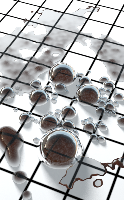

  • Handling of refraction shouldn't change from one renderer to the other
    I made two quick examples for Iray and 3delight. I have no difference in the refraction through the glass with custom shaders
    For the absorption, I don't think that it is needed for a liquid on a so short distance. Making unnecessary complicated things
    Hi!
    You must have posted a different 3DL render than you intended - glossy refraction is just not cutting it as "no difference". Show us the real deal sans roughness, please.
    Supposing I want to animate the liquid, or just render a fluid sim mid-splash? There will be a difference between absoption and simply multiplying refraction by a colour. Especially if it's something like coffee.
    And since I get very little penalty for absorption - it uses the RT distance reported by that very trace() that does the GGX reflect/refract - I just don't see the advatange of complicating the user interface with even more switches. There is more use to RT subsets than only this cheat =)
    I don't see absorption in your render.And I think you got it wrong. The distance given by trace() is the distance to closest intersection. So are you calculating absorption based on the distance to an occluding object?
    Here is an other render. This one is with volume absorption. I don't think I got the refraction right.

  • Mustakettu85Mustakettu85 Posts: 2,933
    edited September 2016
    Exactly. It takes objects inside the refractive mesh into account. And when there is none, it hits the other side and calls it a day. It may become too much in places like corners with multiple bounces, I think, because I don't cut it off at any ray depth. But it's believable regardless.
    It handles shallow water with increasing depth when the water is just a plane:
    https://mustakettu85.files.wordpress.com/2015/09/shinyfakewater.jpg
    And this isn't exactly coffee but getting there (Spacebone's water OBJ, SickleYield DS4-fication):
    It's definitely not a 150% physically correct sim of absorption, but for artistic purposes it doesn't look that bad.
    433 x 700 - 475K
    Post edited by Mustakettu85 on
