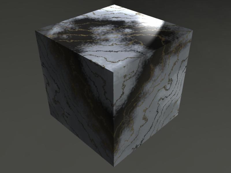

    uvmap - learning by trial and error
    right or wrong, this is how i made it:
    wanted to do the top as box template, and the sides as cylinder
    started by slecting top, Selection,by shader domain = top
    then clicked the uvwrap symbol - right top
    Display tab, unchecked 'show all'
    verified 'top shader domain' was selected in shader domain list
    model tab,  mapping: select "box face"
    clicked "top"
    clicked operations tab
    not sure if i needed to, but hit 'detach polygons' button
    Projection selected box
    box mode: selected the plain sheet, Apply button
    back to Display tab,
    export,
    map size - selected 1024
    next-map the sides
    still in display tab,
    selected the shader doman for the sides
    top menu, selection, by domain, selected the Txtsides domain
    Display tab, verified the txtsides* was selected.
    Operations tab, detach,
    projections selected cylinder
    made sure the z arrow was highlighted
    Apply button.
    Back to display tab, export, map size = 1024
    did same for last shader domain, the steplip
    opened templates in photoshop elements.  applied patterns and text to test uv

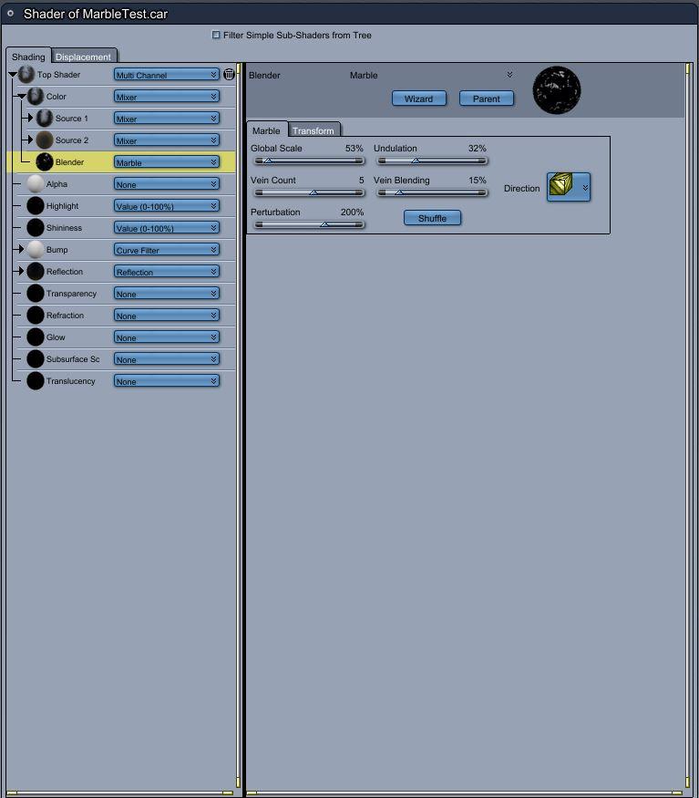

    @MistyMist - I'm not sure what kind of material you are going for there (although it looks cool) but in case you didn't notice there is also a "marble" shader under the natural functions.  You can create some pretty cool effects by nesting a few different marble shaders together. :)

    thanks smiley
    think i used blue granite shader, was in the wizard, dont remember which, remeber looking through rock n stone, n natural

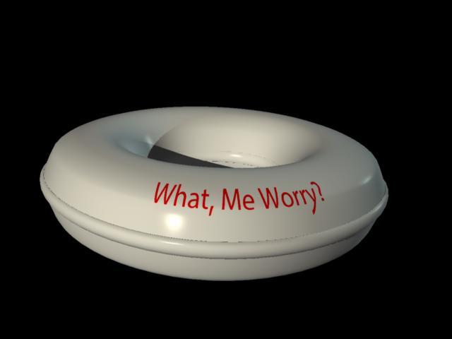

    Splines!.  Instead of using the vertex modeler to make a torus, and then uvmap,, etc., I used the spline modeler. There is a torus preset in the spline modeler.  Just use the pen tool to draw the shape and then use the preset.  Use the shader room's rectangular layer tool to block out the place for the text.  I wrote "What, me worry?" in white text on a black background in photoshop but you could render it out in Carrara.  I used it as the opacity mask in the rectangular layer shader.  Unlike a vertex model that has been uvmapped, it is relatively easy to continue adjusting the shape and textures of the spline torus.

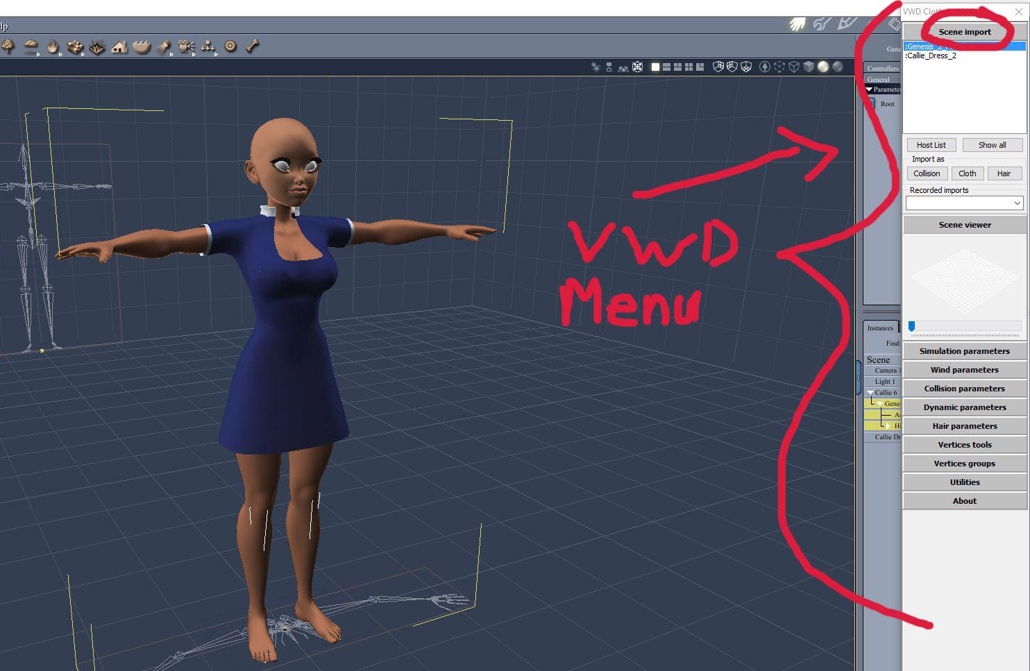

    I wasted some time using VWD.  It worked great, that is not the issue.  The problem is that the good part of the drape (IMHO) is hidden by the lifesaver.  Anyway, I loaded Callie 6 and modeled a simple dress to fit it shape.  I then used VWD to convert my custom dress to a dynamic prop fitting the posed Callie 6.  Woohoo, it worked.  Boo, you can't tell in the final render.  Anyway, here is some of the workflow.  Also, I modeled hair caps and then grew strand hair.  The ship is from the browser but retextured.  The G2M (Corey) is wearing content from the Daz store which I will specify in an edit (EDIT: IH Kang's casual A outfit).  The ocean is a terrain primitive using the advanced fractal generator and with a water shader.
