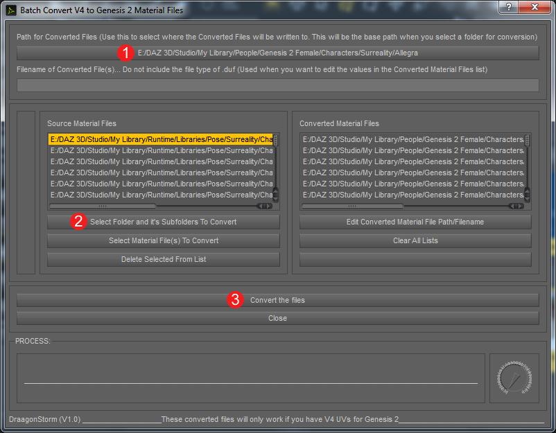

    Create a new Subfolder in your DAZ Library. Start the Script ( DAZ Studio Formats => My Library => Scripts => Victoria 4 Skins Batch Converter ). Follow these steps:
    1. Point to the subfolder you created
    2. Point to the folder where the material presets are located
    3. Convert the files
    Post edited by MN-150374 on
  • Draagonstorm, please get on DAZ to put out a product update that includes the pdf manual, and link to it in the product's readme. I found this thread after searching around the net for some kind of documentation for your product. I have the pdf you linked to here, but it really should be included with the product.
    People confused about where to find the relevant pz2 files to import should note the screenshot above. It's showing Runtime>Libraries>Pose. That's where to look. It's a good idea to make a subfolder just for the character you're going to convert. Make this in the Genesis 2 Female>Characters folder. I'm converting one character at a time.
    Some of the pz2 files are for injecting morphs. I don't want to convert those. I find it easy to just click on "select material files to convert" instead of "select folders and subfolders." The program shows me PNG files instead of pz2 files. This way I can look at pictures for easy indentification, and I select which materials I want. The program then finds the corresponding pz2 files to convert.

  • Please help me I am still having troube using this. I just doing something wrong I'm sure but its very frustrating
  • Victoria 4 for Genesis 2 female (This is the folder I want the converted files to go) but when I get to this (select folder and its subfolder to convert) I get nothing!
  • What is in the folder right now?
