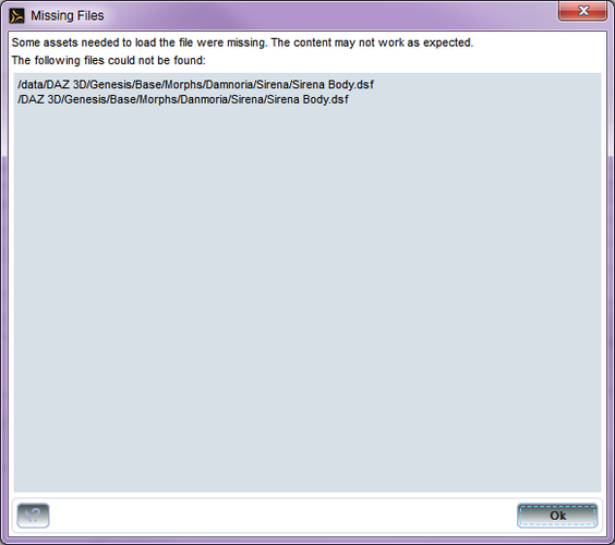

hi
i've got this message at the start of daz studio 5 and ervey time i create a new genesis
i've reinstalled it nothing change and the files are here
thanks for your help

    i found a fix about the problem
    posted by producer
    *DanmoriaAug 18, 2012 Professional Digital Artist
    Ok, it seems that i've found the problem. There is a wrong file in that bundle and that is processing this error.
    Quick Fix:
    Go into the data-folder of your DAZ-Runtime:
    your Runtime: data: DAZ 3D: Genesis: Base: Morphs: Danmoria: Sirena
    and delete the file from the Error Message: Sirena Body.dsf
    You should now have the following data in that folder:
    Sirena Backspikes.dsf
    Sirena Ear.dsf
    Sirena Eyebrows.dsf
    Sirena Gills.dsf
    Sirena Head.dsf
    Restart DAZ Studio and see if the error message is popping up again. If not, everything should work right now.
    Hope that works for you
    In first step I try to rename the file instead of delete,,,
    But the error comes with the new name
    I move the file on desktop and delete the main,,
    That Works!

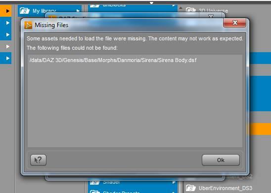

    Can you please make a screenshot of that error for me?

  • HeraHera Posts: 1,970
    edited October 2012
    I don't know the tag for posting images, please click on the link instead
    Post edited by Hera on

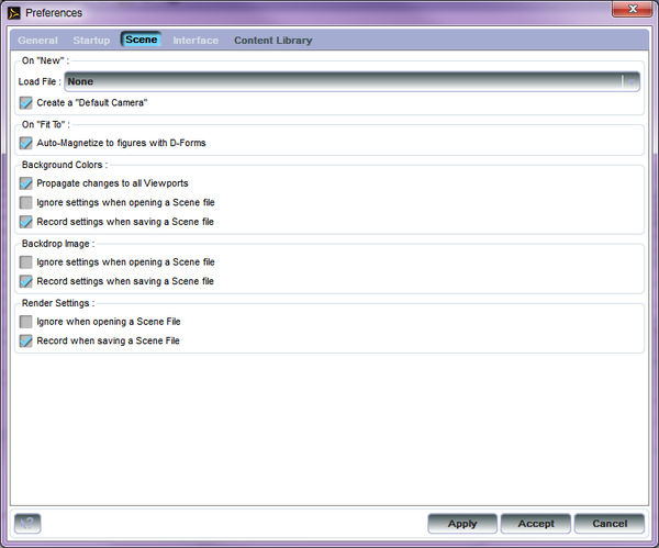

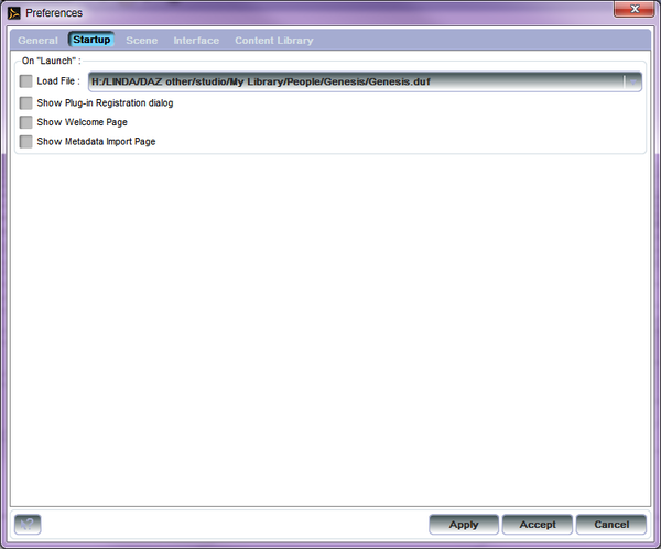

    Check your preferences (edit>preferences), and check on both the startup and scene tabs for custom scenes that may still be calling for the bugged version of Sirena.

    Okay pic 1 is the error message I'm getting:
    Pic 2 is the startup:
    And pic 3 is the scene:
    I still can't figure what is wrong. The file mentioned is nowhere to be found of course and I imagine that is why I get the message, but how do I get rid of it? Shall I remove Sirena? I'd rather not because I like the figure...

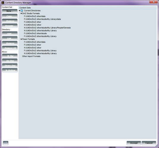

    I wonder if you've had Sirena installed to more than one content folder at one time. Can you post a screenshot of your content directories in your content manager? Edit > Preferences > Content Library > Content Directory Manager and click the + signs to expand the trees.
    This is what it looks like. I'm not really sure what to look for. And yes, Sirena (as the rest of the content) is installed to both F and H, the latter being a separate disk which I use when I'm working from another computer.
    887 x 829 - 79K

    If you have only the one default content library this is all wrong.
    1. Is the only path that should be listed and it should be the TOP DAZ Studio path.
    2. Should not be listed at all if it contains the same content as 1
    3.This should be the only path listed and at the top of Poser paths
    4.This should not be listed at ALL if a copy of the content as said before.
    You should only have one path listed twice, once in each format if all your content is in My Library.
    If DazOther holds content it should be listed once in both as well below the default path.
    887 x 829 - 75K
    Post edited by Jaderail on

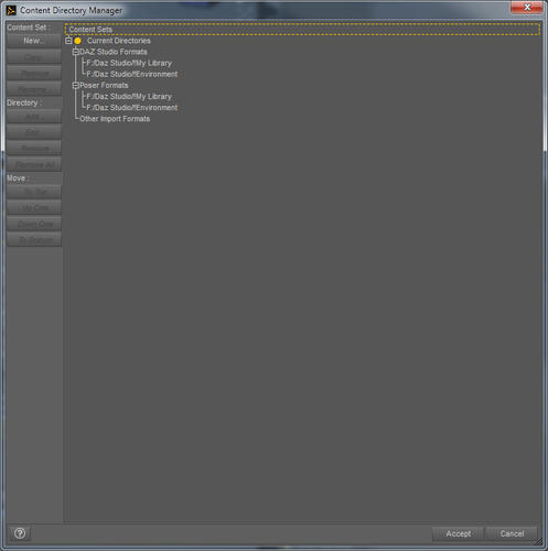

    I'm only trying to help. And If it works it works, knowing what I do I'm very surprised it does because frankly it shouldn't. This is a Default content folder and done properly. I get no issues ever done this way. The Location of the folder does not matter, but how it is listed does.
    471 x 386 - 29K

    edited June 2013

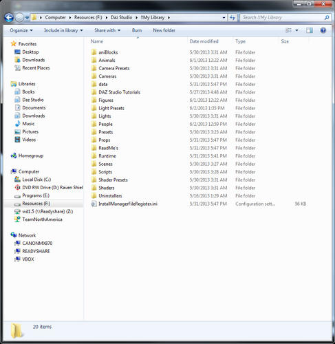

    This is why you're receiving errors. You have nested folders that shouldn't even be mapped. The /data and /People/Genesis are INSIDE of /My Library, therefore you should only have the /My Library mapped. You should only be listing the library itself, not it's internal folders as well.
    This is generally what the inside of a My Library folder should look like, with the !!My Library being the one mapped in Daz (yours may be named something else). None of these internal folders get mapped.
    If you have folders with these names inside of /data, move them one directory up and remove /data from your content library listing.
    /edit
    You CAN have multiple libraries; however, you only list the top most folder of each one (as shown in my 2nd screenshot).
    Not to sound like a pain in the ass, but the longer you leave it like this, the more problems you'll face down the road and the more you'll have to fix.
