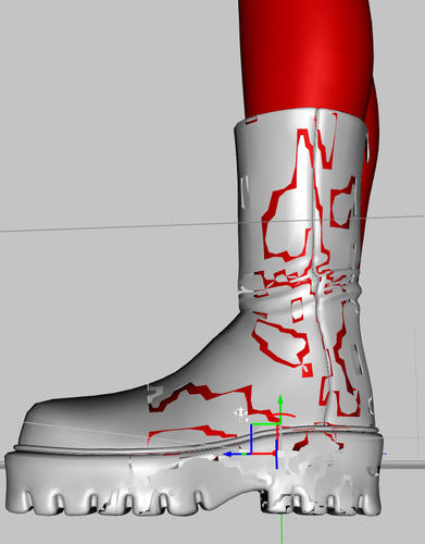

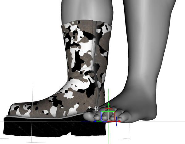

    Close but no cigar. I must have missed something. I've been toying (bumbling) with a similar method and had little luck, so this is just what I'm looking for. I tend to attempt a reinvention of the wheel when it comes to these things so I haven't seen the other similar threads about.
    I would love to be able to use all my old favourite boots. Ah! Just noticed the mesh goes to hell when I add the smoothing modifier. I think it has something to do with the last export into/out of Hexagon (I had to do it twice for the same figure). A damn shame that a simpler "click and done" autofit hasn't been developed for boots yet. The market for a script/plugin would be hungry indeed.
    642 x 821 - 93K
    Post edited by Jim_1831252 on
  • Richard HaseltineRichard Haseltine Posts: 109,378
    Looks as if there are unwelded vertices somehow - which boots are these?

    They are the cyberpunk boots. I haven't had a chance to try from scratch again, but I'm fairly sure it won't happen again.

    No, the problem isn't Hex. I didn't have trouble till I needed to export the boots a second time (I accidently exported an additional primitive the first time). Something happened to the materials - all the missing parts somehow ended up as a unique material.
    I did get lost a couple of times after step 20 or so, but I got the gist of what I had to do as I have some experience from playing with the tools myself.
    Thanks by the way, it is good to have a practical solution to the problem of auto fitting boots. I'll let you know if I get it worked out. Actually, I may go and try it right now.
  • Jim_1831252Jim_1831252 Posts: 728
    The problem was exporting from Hexagon. I had the wrong settings (just happened again but have since changed options and got good export). I think your method would be as quick really. The import/export doesn't take as long when you know what you are doing, but can look complex to the newb.

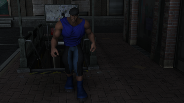

    And here it is, the sweet stench of success. Many thanks Supercope ;)
    868 x 675 - 90K
    AWESOME!
