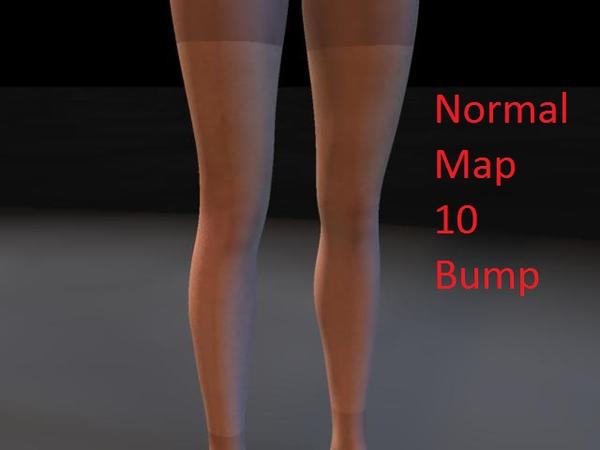

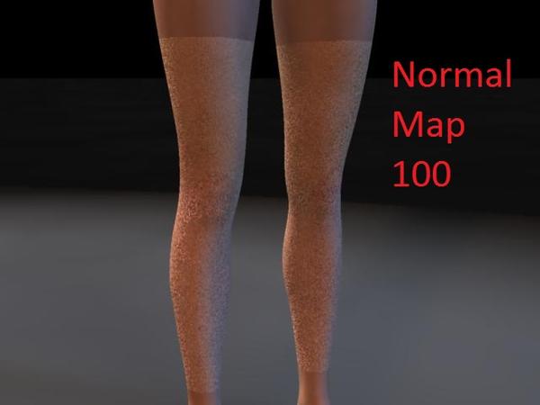

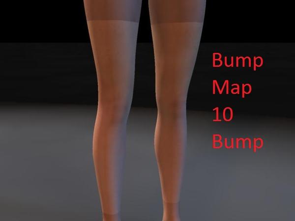

I am dipping my toe in the "photo-real" pool. To get started, I am trying to learn skin shaders. I picked up a G2 Female merchant resource by Forbidden Whisper that is really designed for Studio. I am trying to adapt the resources for use in Carrara. I have applied it to the legs (not upper thighs or ankles/feet) so you can see the difference from the default shader. I have set the highlight and shininess low but have not changed reflection or subsurface yet.
The resource pack comes with texture maps for limbs, face,... in the categories of
- diffuse
- bump
- displace
- normal
- SSS
I noticed that the Carrara shader tree can load a normal map in the channel for bump. Does anyone have thoughts on whether it is better to use the bump or the normal? I currently have it in a mixer so I could combine them, but I am wondering about system resources, render artifacts, and other potential pitfalls.
Also, I was wondering about the potential to use the other maps to get more detail. The displacement map is way too strong but I think that can be addressed. I will add another post to show my experiment with the displacement map and displacement channel. In the meantime, what are best practices for the bump and normal maps?
