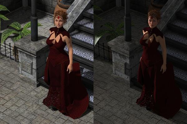

    On the problem with dark gainy shadows, there are several things i would recommend:
    1) Use gamma correction and gamma 2.2. This makes your shadows look brighter and you will need less ambient light to get good results.
    2) On the advanced render parameters use a shading rate of 0.2. The default is 1.0, but that can produce gainy shadows. The Render Profiles for DAZ Studio 4.5 gives good ideas on how to set the advanced render settings to get good results. It is a speed/quality trade off.
    3) Use UberEnviroment 2 or the Advance Ambient light to add ambient light to your scene. You should have to turn these lights down to 30% or 40% intensity if you are using gamma 2.2. You still want the distant/spot/point/linear point lights providing most of the light in the scene.
    Thank you mark128! Your advice has made the world of difference to my renders. They look so much better now!

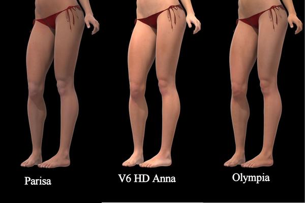

    I have one more question please - how does one achieve the shiny look to skin (such as shown in the images for these products http://www.daz3d.com/amazing-skins-for-belle-6 or http://www.daz3d.com/natural-petite-breast-morphs-for-olympia-6 for instance)? Is it purely a lighting thing, or have they done something to the textures or shaders or something?

    It can be lighting, materials adjustments or a combination. Some of the effect in those images looks like just very bright lights that are to the side and slightly behind (rim lights). They also may be boosting the specular in those rim lights.

    There are two kinds of lights, diffuse and specular. Specular light is what is suppose to make the bright highlights on something shinny. Normal lights (distant, spot, point), emit both diffuse and specular light by default, but on the On drop down you can change the light to only emit diffuse or specular. Some people like to have separate diffuse and specular lights (usually at the same position) so they can separately control the intensity of diffuse and specular lights.
    UberEnviroment 2 is famous for robing specular light from scenes. UberEnviroment 2 does not emit specular, which kind of makes sense for ambient light, because ambient light is not very specular, but many people add specular only lights to boost the specular in the scene when using UberEnviroment 2.
    What diffuse and specular light does to the lighting in the scene depends on the material settings. Material has separate setting for diffuse and specular light that control its response. You can try creating separate lights for diffuse and specular and turn up the specular intensity to see what is does. You probably do not want to boost specular in the fill light, only the key and back lights.
    If you want really shiny skin, like it has been oiled, you will have to adjust the skin material settings. Probably you will need add reflection settings in the material and you will have to add something to the scene for it to reflect or you will have to provide a fake reflection map in the skin material.
    To get really good renders you need to learn both lighting and material adjustment. Products you buy in the DAZ store have material adjusted for some kind of lighting, usually it is at gamma 1.0. Sometimes they render really well at gamma 2.2 also; sometimes they do not. The most common material adjustments I have to make at gamma 2.2 are:
    1) Reduce specular strength, common problem on hair and some clothes, never had to do this on skin.
    2) Reduce velvet strength. common on skin and some clothes, a few times on hair. (Note, the DAZ default shader has no velvet strength).
    3) A common problem with hair is the opacity map has gamma set to 0.0. This causes the opacity map to be gamma corrected when rendering at gamma 2.2 and can sometimes make the hair look thin. You need to change the opacity map to gamma 1.0, so it is not gamma corrected.

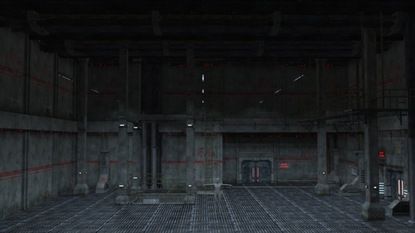

  • SzarkSzark Posts: 10,634
    Everything that is glowing apart from the Sign have the Area Light Base applied and Fall Off set for the Column lights, Light Strips on the right and the small Red lights. Just remember the Area Lights are soft lights and don't gives much specular highlights. If you want more specular highlights then you can add further lights like point lights and set then to Specular light Only. This took 30 mins the render on my i7 3770 3.4GHZ 64bit system.
    If you want it brighter just adjust the ceiling light Neon tube surface's Light Intensity Setting.
