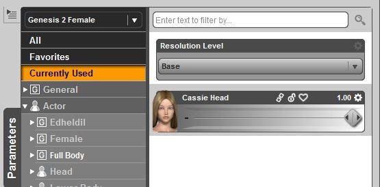

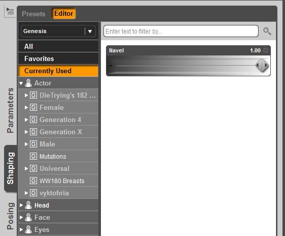

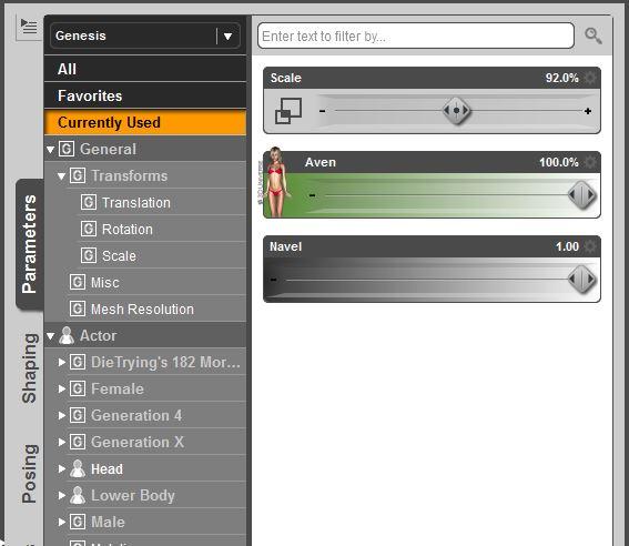

    As MegonNoel said, although the position of the tab may vary according to your layout (in my case the tab is on the right side....)
    However, the shaping tab "currently used" option may not show all that is used
    I would choose the "currently used" option in the Parameters tab (see images)

  • glaseyeglaseye Posts: 1,312
    I don't have 'Norma' so I can't check, but the description says it has a custom head morph; if that is applied, then you should see that morph in the parameters tab.
    However, if it is a 'dialed' preset, then al you will see is the settings of the various morphs/shapes that are used; not the name of the character/model itself....

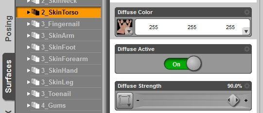

    Now there might be a little trick to see what character you did use if the preset also applied textures (and you didn't change the textures yourself with those from an other character ....)
    In the surfaces tab, if you move your mouse over the diffuse color tab of one of the materials, you may see the texture path and the name of the texture used...... with luck you can deduct which model it came from ....
