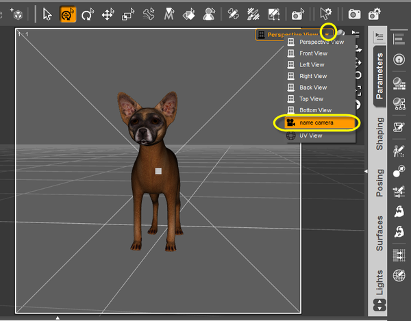

Looking round a scene in perspective mode, find a much better camera angle for scene. How can I load a new camera to this point, or how do I discover xyzTr and xyzRo of current view so I can manually feed that to new camera?

Camera pics attached.
Omg how embarassing. I must have seen that a thousand times and never noticed. haha. I just load a camera and then start moving it about, never studied options. Thanks a lot, that'll help. :)

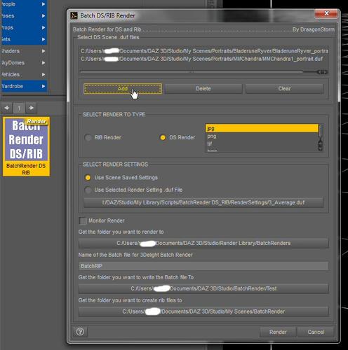

DraagonStorm has a product in the store to do batch rendering. I have it and it works quite well.
Batch Render for DAZ Studio 4 and RIB
I am not a technology person- I'm lucky if I can change the volume on my computer. (Well, not that bad...) Doing "bat" files- what the heck does this entail? In other words, how hard is this product to use? I don't recall seeing it discussed in detail but the forums are huge and I don't surf every section. So how do you use this product if you don't mind me asking?
The bat file are for use with the stand alone version of 3Delight which is a command prompt application (no GUI interface). I assume you are not using that.
The Batch Render product is a DAZ script. There is a icon in the content library to load it. I brings up a dialog box where you add the DUF scene files to be rendered. The only strange thing about it is that when you click add, you select the png files that correspond to the DUF file. I am guessing this is so you can use the previews of this PNG in file browser dialog to see image of the scene you are selecting to render.
You then select the render type. RIB render is for the stand alone 3Delight. For a DS render you select JPG, PNG, TIF or BMP.
You can use the render settings saved in the DUF file for each render or you can use a predefined set of render settings for all the renders. I always use the saved render settings.
You then select the folder you want to render to and click the render button. The rest of the settings are only for the render to RIB option for use with the standalone 3Delight. DAZ Studio will load the DUF files one after another and render them.
If you want to use the standalone 3Delight, this product is a real time safer. When you manually do render to RIB in DAZ Studio it writes the RIB files into a location in your Temp directory. If you want to queue up a whole bunch of scenes for batch render you have to keep changing the value of the Temp directory so they don' t overwrite each other. Then create some kind of a script to run all the renders in the command shell. This product takes care of all of that. Generating the RIBs in different directories and creating the bat shell script to run them.
However, it is very useful even if you just want to render in DAZ Studio too.
