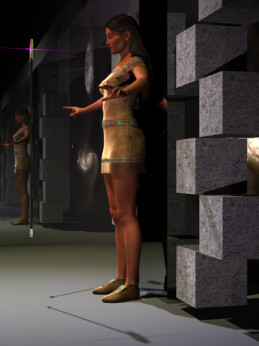

    The ’Wachiwi Hair Xtra' Opacity Strength setting, did get rid of the tails. Don't touch the other sliders as they work in reverse to common expectation!
    Wachiwi, Casting Reflections, sort of. These took about 7min 35sec to render each.
