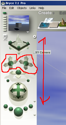

    To move the camera up and down, click and drag the mouse up or down on one of the two icons circled in the attachment. (Or if you you meant to angle the camera up or down without moving it, click and drag the trackball up or down.)
    Not sure about the top view; I actually just assumed it was fixed, but perhaps somebody else can answer that one.

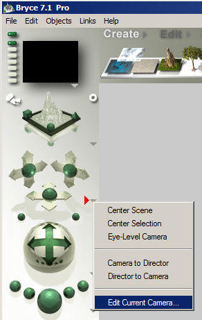

    jodycour you can also go to overhead view, click on the camera to highlight it, and drag it where you want. Use Num Pad 2 or click on the down arrow just to the right of the buttons Sean has circled in his attachment. You can't change the elevation or yaw in Overhead view, but you can position it where you want.
    Also looking at Sean's attachment, there is another down arrow on the right, just below the right side circle in the attachment, which will allow you to edit many things about the camera. If you know the coordinates you can enter numbers into the XYZ boxes under Position and Rotate to move your camera.

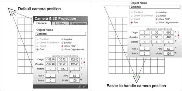

    @jodycour - perhaps the easiest way is to edit the camera parameters directly in the respective dialog. Click on the second triangle from top to open the context menu from which you can open the dialog. In the dialog set the values as shown at right in the second image. Starting from there makes life much easier.

  • Miss BMiss B Posts: 3,071
    Thank you Horo. I've often had a hard time moving the camera in Bryce, but this will make things a lot easier. :coolsmile:
