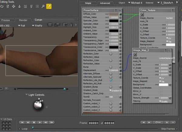

    I am still having trouble figuring out how to get these veins displacements maps to look right? Below is the results I am getting. I am trying to add the M4 SkinOverlay ( veins ) to the arms. You can clearly see my results. I have tried different values and cannot seem to get them to look realistic. Any ideas? Thanks!

    If you're using the set Jaderail posted, that's a Daz only product. For Poser, you'll need to add in a math node between displacement and the image_map and set it to subtract .5. This is only needed when using DS bump/displacement maps in Poser. For maps made for Poser, you won't need to do this.
    From there you play the the displacement amount on the PoserSurface node, mindful of the units you have set in Poser's general preferences.
    If you want more of a 1-click solution for Poser, Zev0 and Draagonstorm have a Vascularity product for M4/V4 at Rendo (currently on sale for $5.56).
    http://www.renderosity.com/mod/bcs/vascularity-for-poser/96321/

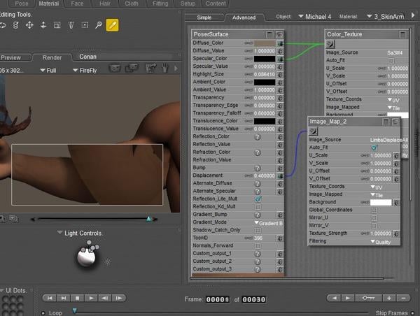

    I did what you suggested.... ( using the M4 Displacement Veins Limbs ) keep getting the same results! Getting sort of frustrated!
    I'll try and locate that Python Script!
    Maybe I am using the wrong type of displacement map? IDK... but I know I am close! lol
    Getting the results below...
    HELP! lol
    1165 x 670 - 137K
    edited October 2013
    I see your problem, you're using the Daz script as the image. You need to locate the texture file under Runtime\textures of the library you installed the maps to.

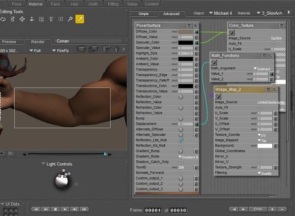

    Still having problems with getting veins going on my figure. Attached are my results. I appreciate anyone's advice. I'm stuck! Thanks
    914 x 689 - 114K
    On Image_Map 2 under Image_Source, are you still using the DSA script as the image like you were in your previous screenshot?

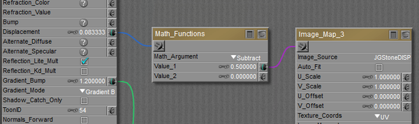

    Attached is what I currently have going on. No I got rid of the script. It turned out that my units were not set to inches. I corrected that problem. I did what Bill suggested over at Runtime DNA. The veins look too weak. I would like strong looking veins as he is a barbarian character.
    Thanks for checking in and helping out!
    929 x 677 - 113K
    edited October 2013
    If you have it set to inches now, try setting it to .5 (half an inch) and see what happens.
    /edit
    I remembered Mr Hyde for Genesis uses M4 maps, so I used his vein displacement on M4 in Poser. Here's how mine is set up. Again. using a math node because the maps I'm using were meant for Daz Studio.
    1332 x 387 - 215K

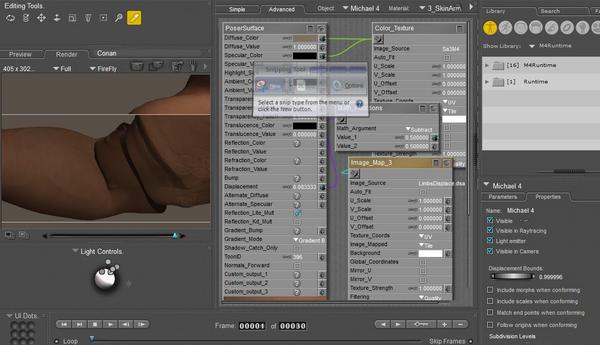

    I'm losing my mind with this vein thing! I'm using the Vascularity Vein Map for M4. I increased the displacement value and I still do not see any change. am I using the wrong texture or wrong map? I'm using the file LimbsDisplaceAll.pz2. I added a math node as well because I think it is a Daz3D product. I put in the values you suggested. I do not see any change in the render.
    I have nothing in the bump. Should I be adding a bump map too?
    923 x 676 - 114K
    You're using the pose preset. Images in the mat room need to be IMAGE FILES. You need to find the JPG for the veins displacement from runtime > textures.
    You could just click on the pz2 from your library panel (library > pose folder) and it will auto-add the displacement map for you.

    I just realized when going through my library that the Vascularity was a script. I went that route and yes it automatically put the displacement map there for me. I just need to fix my lighting like Willy suggested from Runtime DNA. My character is a barbarian so I am trying to make his veins large and stand out. Now just have to play around with the lighting and increase the veins.
