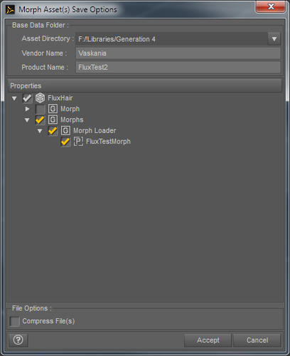

    Ok, if I understand you right, is this your workflow? I didn't bother setting metadata with any of this as I don't use the CMS.
    1. Open HR2 from Poser Formats > Hair in DS and File > Save As > Support Asset > Figure/Prop Asset and set the info.
    2. Delete HR2 from scene and load newly saved DUF version from Daz Studio Formats.
    3. Send loaded DUF to Zbrush (I'm assuming GoZ?).
    5. Morph.
    6. Send back to DS, which starts the morph loader process and name your morph.
    7. Dial in your morph to check that it works and set back to 0.
    8. File > Save As > Support Asset > Morph Asset. Set the info and select only your morphs from the list (don't select any of the original morphs).
    9. Delete the hair from the scene and reload it (from the DUF, not original HR2).
    I just followed this exact process using the Hexagon bridge (I don't have Zbrush) and it works fine. I also used a Gen4 HR2 when I started. This process retains the original morphs as well as added in my newly created one. The morph was still there even after closing/reopening DS.

    I don't know what you're doing wrong then, because as I said I followed my steps exactly and it works. Unless it's an issue with Zbrush transferred morphs specifically.
    Lets try to see where things are going wrong. Are your dials working after they're morph loaded back in from zbrush?
    Post edited by Lissa_xyz on
