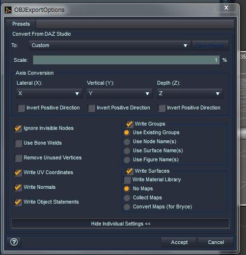

    1. change genesis mesh resolution Level base , subD level zero in Parmeter>General>meshresolution.
    2. In scene tab, only genesis set visible. other object must need to set invisible. by V eye icons
    3. File>export (export obj from DAZ to Blinder)
    Use same option as I tell you.
    a the top property set "Custome" . never choose " Blender" option (it seems old preset for old version)
    b Scale = "1%"
    c Axis conversion Laterial X =X Vertical Y =Y , Depth Z =Z ,
    check off invert option (do not check them)
    d it depend on how you want to export your obj, but I usually choose these setting .
    ignore invisible nodes "check" (must need)
    Use Bone welds "check off" (about Trx weight figure)
    Remove unused vertices "check off" (must need)
    Write UV cordinate, Write Normals, Write Object statement "check on"
    Write groups "check on" select use existing groups
    Write surfaces "check on " select No maps then export the obj . eg test.obj

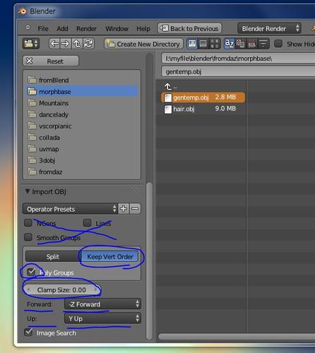

    4 Launch Blender , then import test.obj
    you need tweak setting left side, under Import OBj setting.
    a all Un Check Ngons, Lines, Smooth Group
    b Activate Keep Verrtex Order, and Check ON Poly Groups
    c Clamp Size = 0.00 (default)
    Foward = "-Z", Up ="Yup" (default)

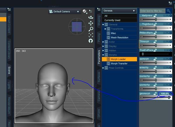

    7 return to DS, then select genesis. (check mesh resolution level zero)
    click morph loader pro.
    a click show individual setting button. then show advanced settings.
    b At this time, you must need to use correct scale.
    I export 1% scale, so that I need to import "10000" %
    c Axis conversion are same, X = X, Y = Y, Z =Z,
    and check off all invert position direction. you need not tweak these option,
    but if you use preset it change these setting wihout your intention. so need to check.
    8 then select your morph target obj, set property group as you hope to see the controller.
    set good name to your morph , create controll properyt = yes, ofcourse
    Reverse defomation, you need not about this case,, "no"
    then Accept.
