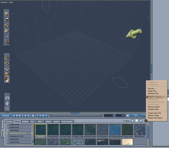

    I hope someone here can help me, but I just purchased this product and I cant seem to locate it or Carrara CloudDomes in Carrara 8. I bought the bundle. Please someone help me out. Thanks.
  • StezzaStezza Posts: 8,951
    see the screen capture..
    when you select the folder browse to your carrara install.. presets... objects.. PhilW Realistic seas ( or whatever you need )
    that should do it .. hope this helps you
