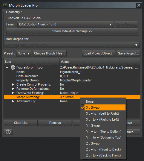

    The script is obsolete since we have Morph Loader Pro.
    Hide everything else in the scene, set your figure to Base Resolution, File>Export>Wavefront OBJ, choose an export Preset maybe Daz Scale 100% (1 unit = 1 cm), check Ignore Invisible Nodes, the rest of the settings dosn't matter.
    Open Morph Loader Pro select the same import Preset maybe Daz Scale 100% (1 unit = 1 cm).
    Press the "Choose Morph Files" button and select your exported OBJ.
    Right-click "Morph Mirroring" and choose X:Swap. Press Accept - done.
    Don't forget to save your new morph File>Save As>Support Asset>Morph Asset.

    I just noticed x: swap is not exactly the same as what this mirrorMT script does.
    If you want a single morph that symmetrizes the same shape on both sides I guess you have to dial up the original and the new morph and do a second export to combine the shape on both sides.
    [Edit]: No its even easier depending on the morph choose X: Left to Right or X: Right to Left to combine both sides with one import step.
    I've leaned this from the youtube video here: New Morph Tools Intro by Josh Darling
