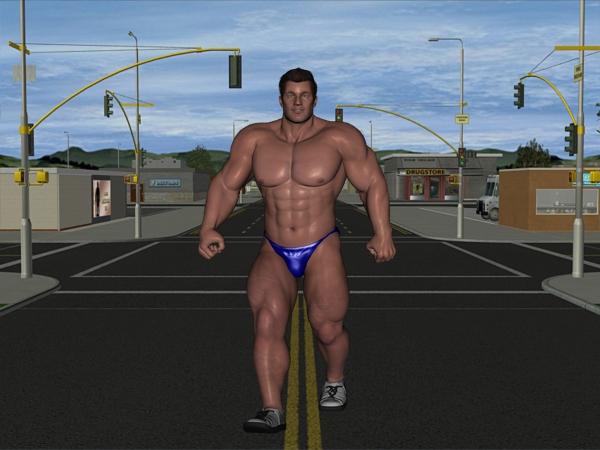

I asked about this once before about to get rid of those texture lines around his legs and especially his head and hair. I got it fixed by taking the skin maps into Photoshop and applying the smoother, softening and expanding the edges just a bit. Then bringing that back onto Brock and the lines are gone.
Hope that helps someone else with the same problem. I adjusted the render editor over and over trying to find the right levels, but all you gotta do is fix the edges in Photoshop.

    I can't see what you're talking about in your render.... are you talking about seams?

    The render is with the applied smoothed skin I did in Photoshop. Otherwise, everytime I rendered Brock you see the green texture lines around his thighs and especially around the hair and sometimes around his face. As I said, I have gone through the render editor settings SO many times trying to figure out to get rid of them. But all I did now was take the skin map into Photshop and smooth out the edges. It still helps to keep the shading rate down.

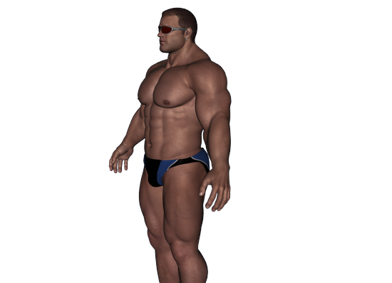

    This is the original figure before I applied the smoothing, even in dimmer lights and the shade rating down those lines around his thighs and his head are there. I HATED that.

    The trouble is that does blur the textures slightly - the fix of adjusting the maximum texture size and shading rate should avoid the issue without blurring.

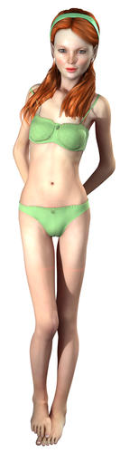

    Darn, not SSS group, both zones are group 1. Here's the image (finally on the right system), really happy with how the skin is looking except for that silly line between SkinHip and SkinLeg.

    Okay, there's definitely something out of whack in my surfaces settings. The original textures are from Dublin, i tried reloading the original pose on the figure, I see the seam. I tried undoing all of my morphs and just dialing up V4, still see the seam. I deleted my Genesis figure and started with a new Genesis figure morphed to V4, loading up the original texutres, no seam. I then loaded my materials presets onto that figure, the seams came back.
    So, that at least is telling me that I'm missing something in my settings for the surfaces, back to the digging.
  • adaceyadacey Posts: 186
    Eureka! Apparently I'd somehow accidentally used the head specular map for the ambient and specular strength. Weird that I only saw the seems in that one spot but easy enough to fix once I found it.

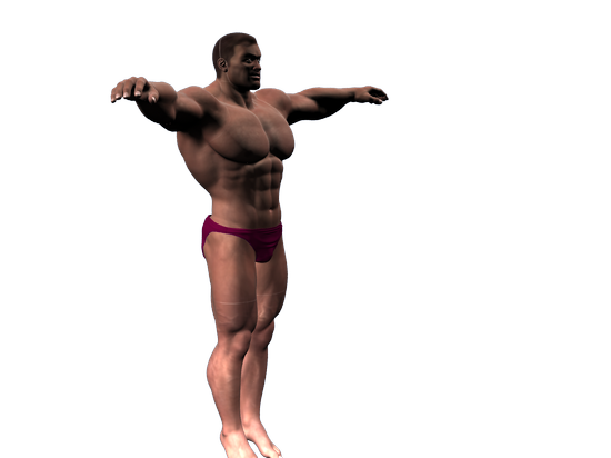

    what I ended up doing was just give new skin all together. I used the Benny character for the skin, and for the hair I used the Brock bald head and added the Billy Hawk hair... This is my Brock character for the "Muscle Shores" series. I took the glossiness in hs skin way down to about 25%, still don't like the plastic doll look, but hey. But his eyes I had to reset the gloss.
