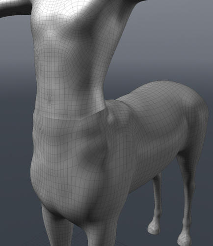

  • Midnight_storiesMidnight_stories Posts: 4,112

    Could be possible I don't know, it's easier to get rid of the whole pelvis. I got a few monsters in the que at the moment.

    Nice start. I think there would be enough sales for such a creature esp one that could morph and wear a good amount of the Genesis wardrobe.
    Yes the geo stuff is not my cup of tea I've only ever played around with tails and horns. Matching the topology of genesis is pretty important to, so have got it as close as I could get, this is done in modo with the SUB-D on to gives you a better idea. Oh well something to do no a Sunday afternoon.

    OK I'll give you the drum on this!!!
    For the GeoGraft to work there must be matching topology
    So that means some part of the horse has to have the same set of vertex co-ordinance as genesis.
    there is nowhere on either one that is remotely close, even if I made a morph on genesis to fit the horse
    there's no matching poly loop to do it with.
    The only way around that is a double graft and I don't think that is possible.
    It would be a bridging piece between both models and since two different model can't own the same
    Bone them it's not possible.
    What you see here is another horse model all together so different topology to the new horse and therefore
    a different UV set. The only way around it would be getting Daz's permission to change the topology on the new horse
    to match, and I don't think that will happen.
    714 x 909 - 212K
