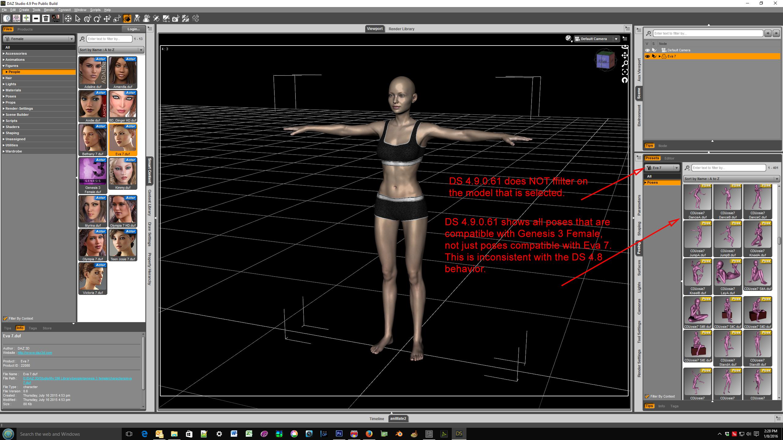

    Pose filtering in DS 4.9.0.61 does not work the way it did in DS 4.8.0.59. This seems like a bug to me.
    In DS 4.8.0.59 I can select a specific model, like Eva 7, in the Posing pane and only poses for Eva 7  will be displayed.
    In DS 4.9.0.61, when I select a specific model, like Eva 7, in the Posing pane, I still see all poses for Genesis 3 Female. The filter seems to do nothing.
    2560 x 1440 - 1M
    2560 x 1440 - 1M
