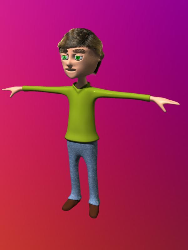

  • DiomedeDiomede Posts: 15,410
    edited December 2015
    Thanks for the nice comments, Headwax, Stezza, PhilW, and Pimpy.  (Edit: and Dart!  Must have been typing at same time)  More progress.
    1)   I created morph zones and morphs for the models. There are separate meshes for the character, the vest, and the eyes.  These placeholder morphs are very important so that the model can be edited using the vertex modeler in the posed position (animation mode in the modeler room).  Once the skeleton is attached, you can't add a morph unless one already exists.
    2)  I set up the bone structure for one side and duplicated the limbs with symmetry.  I grouped the unattached mesh and bone skeleton and saved to the browser.
    3)  I exited and started a new scene.  I loaded the character group.  I selected the character model group and the bones hip and used animation: attach skeleton
    4)  I did a sample pose and rendered with the default distant light.

  • HeadwaxHeadwax Posts: 10,489
    soon you;ll be up there with 3D Universe  !!
    to add morphs at later date @Fenric has an unlock plugin which will do it.

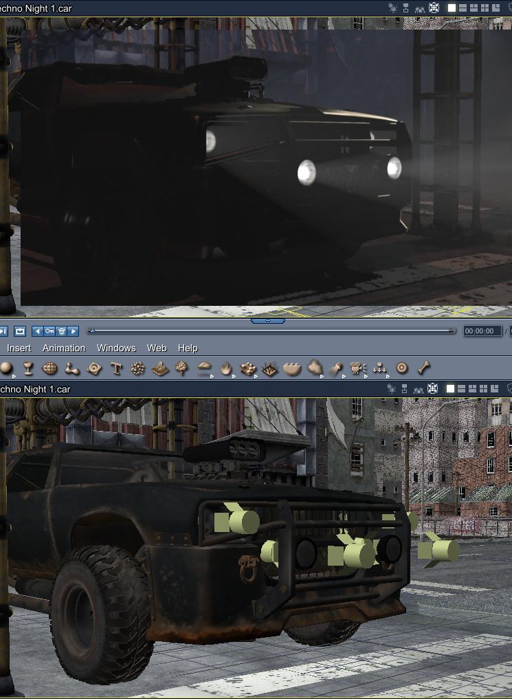

    Sure hope I can get this done on time. Fun to be doing this after being so absent for so long. I still feel a lot more absent from this forum than I'd like... but I'll take what I can get ;)
    Here I've used sort of the same idea for lighting the headlights of this car as what I've used in my streetlights WIP earlier. (How do we get a link to a particular post?)
    The difference is that, instead of sending the actual illuminating lights outwards, as would be more realistic, I've aimed them at the headlights and adjusted the half angle and distance to the model to fill the reflector of the lamp. All of the virual light coming from the headlights is off screen, so I don't need that. You'll also notice that I've added a lot more detail to the streets scene. This is a low-res render of the car in a placeholder position, as it may move as the scene matures. It will also benfit from a bit of postwork in the end.

  • DartanbeckDartanbeck Posts: 22,022
    So there are actually eight lights. Four for the cone effect, four to light the headlight reflectors.
    thanks for the explanation dart, effect works really well !

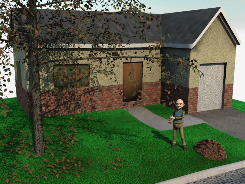

    For the house, I started by opening the ground object and selecting the foundation shading domain.  I copied that.  I inserted a new vertex object.  I pasted the foundation copied from the ground plane.  (Remember, the foundaiton shading domain should be flat).
    - add thickness
    - Use extrusion and other modeling tools to create the house, doorway, windows, garage door, and roof.
    - Make shading domains for roof, walls, etc.
    - I like to have the doors and windows separate objects so they can be opened and closed easily, but in a situation like this I am not sure it matters.
    - Here is a neat texture that I made to simulate a house in which the lower half is brick and the upper half is not.  For the walls' shading domain, I created a layer list shader and used the natural function ELEVATION to create the opacity mask.  This created a separate shading component for the upper and lower part of the walls.  Hopefully, you can see the brick on the lower half.
    - The grass texture is a mix of two terrain shaders that come with Carrara, but it doesn't matter too much because it will be covered with "grass."
    - For the grass, I used Carrara hair set to very large with some frizz in the shader.  The shader has green gradients for root and tip.
    - And here is a test render of the house and lawn together.
    EDIT: And I added a Carrara tree, changed its textures, lengthened the trunk, and played with the leaf textures.  I also used replicators to scatter leaves on the ground and to create a pile of leaves.  And Mr. Grumpy is standing there waiting for me to model him a rake.
    I will need to revisit all of the textures and a few of the models.
    Superb work diomede, I never knew you could do that with an elevation thing, and never heard of the opacity mask! Must investigate. The whole scen looks magnificent.
