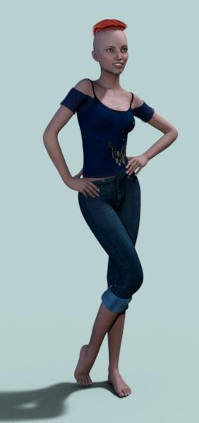

    I would experiment with increasing contrast for your figure, not sure if this is correct though regarding shadows so someone can hop in and help. Perhaps try the Crush Blacks in the Tone Mapping section,(under Render Settings)  increase that to .40

    Aha, Crush Blacks does indeed increase the darkness of shadows too. I am doing a second render for you, with.20 compared to .50 and you can see it. It will be a few minutes.

    The first is with Crush Blacks at .20 and the second is at .50. These are only to show you the effects, they're not "good" renders.
    So again, which set are you using and having trouble with? They are working okay for me.
