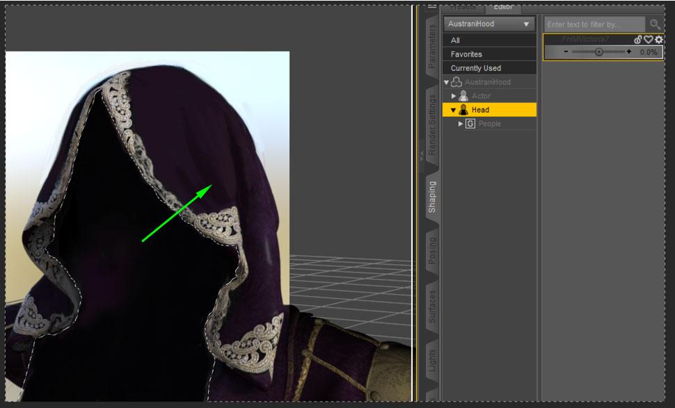

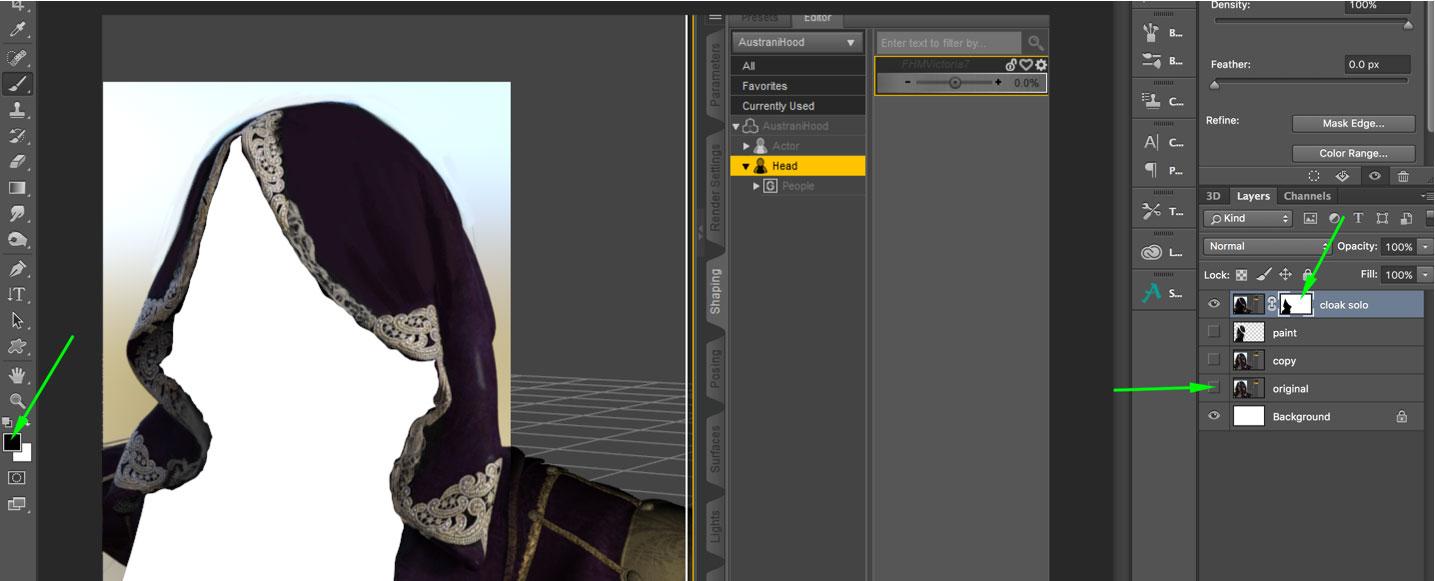

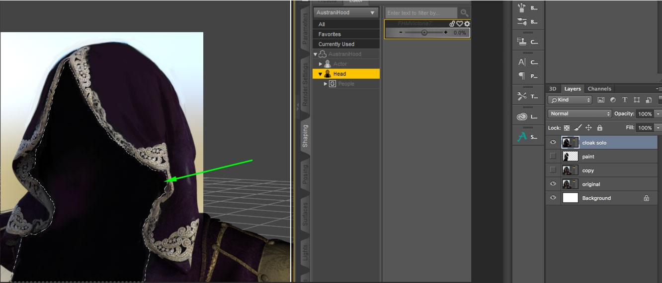

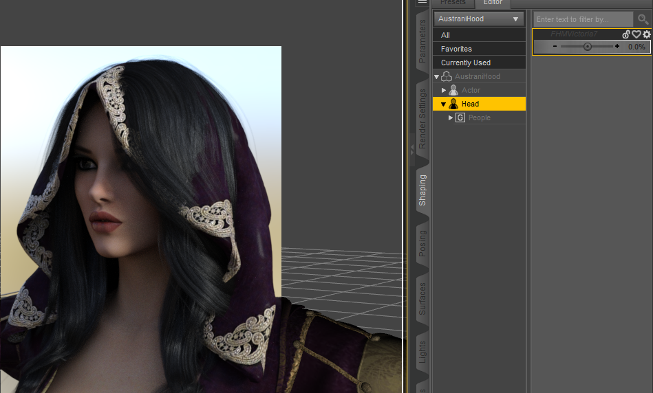

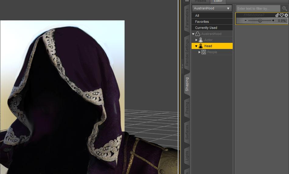

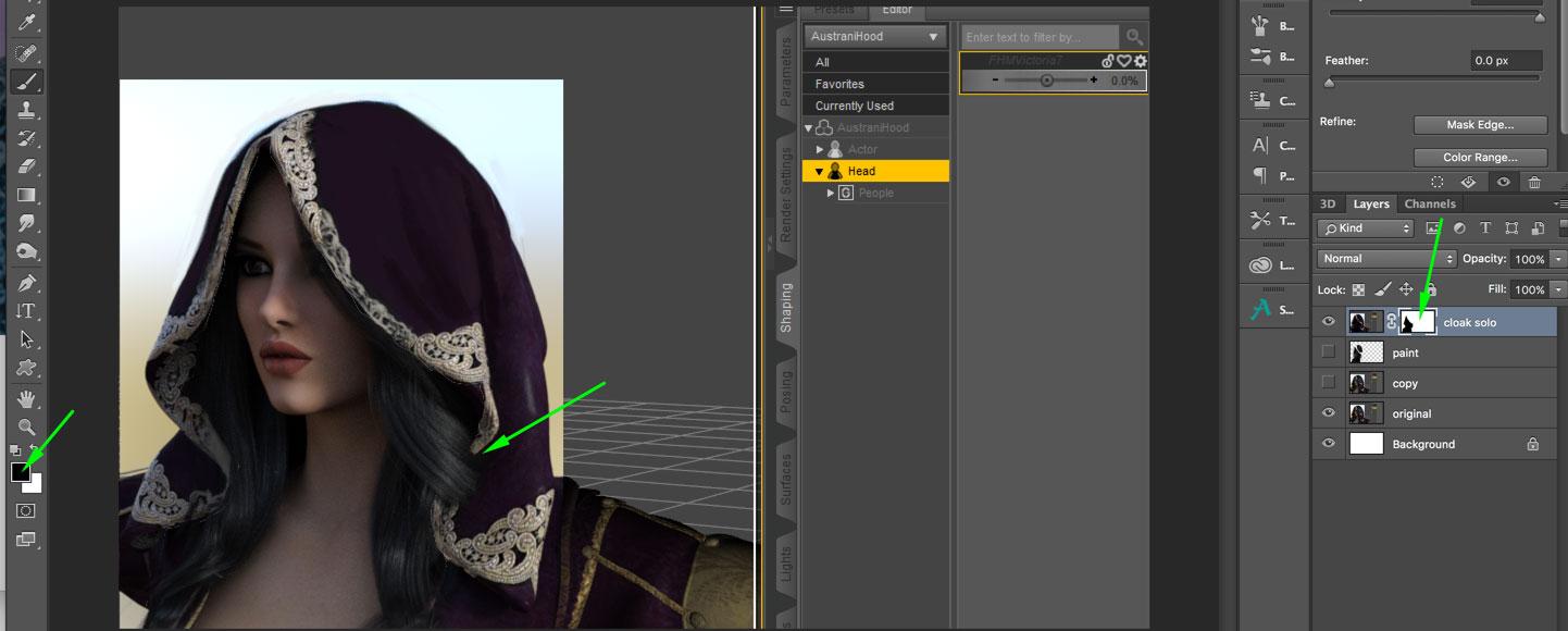

    When you first learn to use anything, it can be hard depending on you grasp it.  As for adjustment layer masks in Photoshop, they are well worth learning to use.
    Here's what you could do.
    1.  Say you have your head in the cloak as you show the pic and render that.
    2.  Now you make the figure and accessories invisible (sometimes you can do just the hair, many ways to go about this depending on what you want as the final result) and render.  I just quickly painted to simulate this.
    3. Now you both layers and you select the inside area of the cloak where your figure and hair are.  What is in the selection will be remain when you create the layer adjustment mask, but you want to hide what you have selected, so invert the selection (Ctrl i/ Cmd i).
    5.  I've disabled the original render so you can see in white what is now gone, but because it's an layer adjustment mask, it's actually still there and editable.  This is what is known as non-destructive workflow.
    6. Now with the original visible, you can see it showing through the cape.
    The hair might even look suitable at this point, but say you want some of it to curl out over the cape as in the original render.  By painting with black in the layer mask, it will increase the mask and reveal more hair.  If you overpaint and reveal too much, you can paint with white to hide.  Notice that there are some small white dots; this is just from the mask and be corrected by painting a bit of black over those white bits and you end up with this result.  Again, because it is non-destructive, you can mess with it as much as you want.
    Please note this was all done and painted very quickly for the purpose of demonstration.  For the real thing, you will want to spend a bit more time with your masks to make them look as clean as possible.
