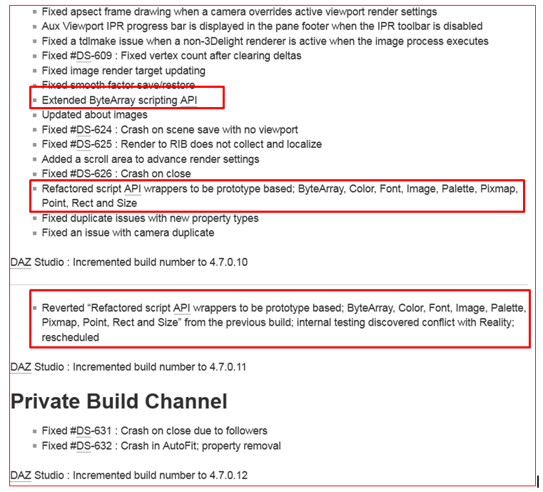

    It is part that I submitt to DAZ, here is where I think is the problem, it is a simple suspicion, withou true knowledge endorsing it:
    "Toonycam pro came in DAZ store in February 2014, for DS4.5 or DS4.6, I don’t remember.
    ID was working perfectly in DS 4.7 Public Beta 1. I test camera in this beta in depth. I install all by DIM since the postgre change
    I believe (actually not sure) Toonycam ID worked in DS 4.7 Public Beta 2, build number 4.7.0.10.
    When general release 4.7.0.12 came, Toonycam ID didn’t work. I tested this too."

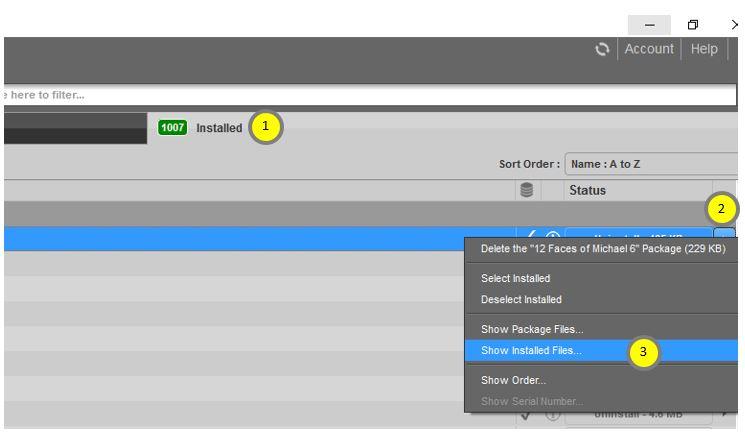

    • First fire up Daz Install Manager.
    • Click on the yellow circle 1
    • On the filter textbox input ToonCam
    • Once located, click on the RightArrow, yellow circle 2
    • Click on Show Installed Files yellow circle 3

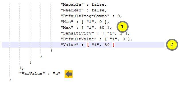

    • Locate the main DUF file and try to open it with a text editor, you might need to uncompress if it is.
    • As we are goin to make changes it is a good idea to backup, but you can allways recover the original package by uninstalling/reinstalling the Toon camera inside Daz Install Manager wink
    • Inside the text editor locate the lines with the text "VarValue" : "u" as shown in the second image.
    • You'll have to replace thoses numbers, the 40 in "Max" chages to 42, the 39 in "Value" changes to 41
    • Again, locate the lines with the text "VarValue" : "v" as shown in the second image.
    • You'll have to replace thoses numbers, the 40 in "Max" chages to 42, the 40 in "Value" changes to 42.
    • Make sure that all occurrences of each "varValue" are replace accordingly, normally there are just one set for each "VarValue"
    Daz Install Manager StepsText Editor Steps
    Some times the .DUF file does not contain the mentioned lines, that's because the actual camera is defined elsewhere, but referenced on top of the .DUF file with an .DSF extension, if this is the case edit the .DSF instead. If this is the case fix (edit) all .DSF file in the same folder.
    HTH
