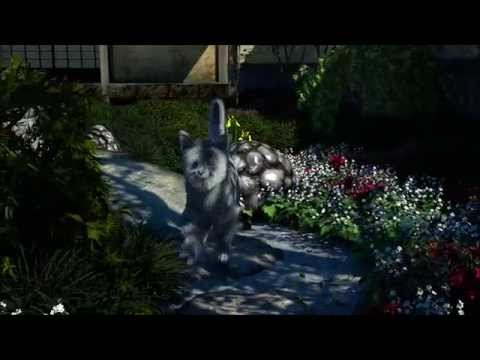

there, said my bit now maybe some of the converted can add some renders if they venture out of the Carrara forum, I do animations and YouTube not em beddable so click my sigline
a Vimeo one

    I see you added a video, was that direct lighting?
    Post edited by larsmidnatt on
  • Yes I do not do unbiased much for animation

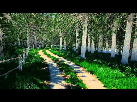

    Definitely worth considering yes. What's the content/scene you're using in the video?

    Merlins wild boarder
    Octane not fond of carrara's trees but mesh trees amnd plants even with transparency it loves and can replicate thousands.

    How does it respond to Howie's scenes?

    not well with the carrara trees
    in fact impossible for me except Harpsburg
    but if you swap out the trees
    country lane with Dinoraul's norfolk island pines
     or save as mesh depending on your RAM is possibe
    most max out my RAM but after heavy polyreduction in UUW3D got a version of the Tea garden in
    I had to retexture most of it and you can see how low poly the meshes are

    Yea, Howie's scenes with all those trees are pretty heavy on the system. The Alsace/Harpsburg video looks really great. Must have taken a long time to render these videos?
  • no not really
    certainly not compared to Carrara native render
    I use between 10-50 samples for most for animation as if full HD not much difference viewed on youtube anyway
    emitters and indoor scenes cause fireflies and those need longer but outdoor easy can fly through at 10 samples indirect lighting
