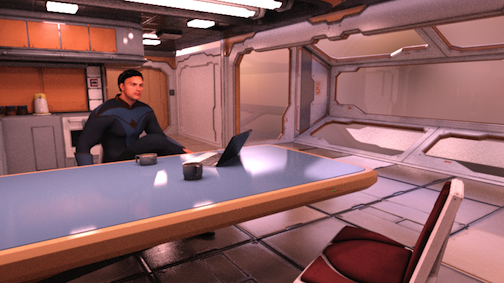

    Thanks. I'm using Dome and Scene and the Draw Dome is set to on, but I see nothing out the windows.
    504 x 283 - 276K
  • tl155180tl155180 Posts: 994
    It looks to me like you have an HDR loaded into the environment map and its all blurred. Have you tried removing the image in the environment map?
    I assume you are using some sort of 'space' map...if it isn't a true high dynamic range image, it's probably not going to have enough 'range' to actually make enough 'light' to be seen over the lighting in the 'room'.
    Also, you need to make sure your windows are set up properly, material-wise.

    @dkutzera "Mode set to Dome and Scene. Set to Finite Sphere. Draw Dome On. Visualize Finite Dome on. Enviro Intensity at 1. And the stock Ruins 500 HDR loaded. and still no sky out the window.
    Are all "sky domes" in Iray these invisible HDRI's?"
    Hi dkutzera - I think you posted in the wrong thread by accident, but I know what you're talking about so its ok :)
    The Ruins 500 HDR is for lighting only - its not meant for image. Thats why you're getting a blurred image on the dome. Remove it from the environment map and you should see blue sky instead.

    And when I remove the HDR in the scene I winds up with a straight line (horizon?) outside the window. Above is white and below is gray. No side of blue anywhere.
    There is no simple way to see which HDRis are going to be blurred/sharp, if your OS doesn't have the HDR support to view them as thumbnails, in the file manager.
    But one general rule of thumb can help...file size. Small resolution/file size images will be lighting only. Large size (5000k x 2500k resolution and up...6k, 8k and even 15k) with a corresponding large files size (10s of MB...usually over 40MB) will be both usable for lighting AND as backdrops. Often though, there aren't corresponding HDR images for use as backdrops in many 'sets'...they substitute a small HDR image and a higher resolution jpg/png/other low range format image for the one large HDR image.
    The grey is the Iray dome ground and the line is indeed the horizon. The white is the sky - its probably white due to your sun settings. You're probably looking right at the sun. Try changing the Latitude, Longitude, SS Time etc that sort of thing.
    As far as HDRs go, I am no expert so I'd rather not fill your head with advice that might not be correct. What I've been told is that some HDR sets contain files only useful for lighting, whilst others are the complete deal with images for the background too. Determining which is which is an art I haven't yet mastered :)
