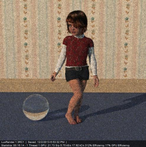

    Observation: the hybrid renderer is slower than the sampler render. I think my CPU and mother board are too old. My GPU's load is around 12%.
    I'll stick to the sampler render until I get a new computer. Bye
    edit: I'm using the sampler renderer with path surface integrator. The hybrid renderer is more efficient than the sampler, but it produces renders with more noise. I guess each renderer displays each picture differently. I should change the surface integrator back to bi-directional.
    edit 2: I found the answer at GPU Efficiency stat in LuxRender
    ok, bye
    569 x 576 - 203K
    Post edited by starionwolf on
