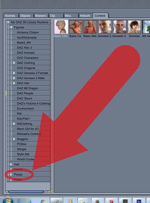

    what remains a mystery is what I do next, that won't load and brings a window that it is not a runtime folder. If I go up the tree and find the runtime folder and load it it looks like nothing extra is loaded. The items remain the same and there is not morph++ folder added atthe tray on the left.
    Post edited by NASSOS on
  • DartanbeckDartanbeck Posts: 22,027
    edited February 2017
    The morphs will be inside your Poses category.
    Click the little white triangle next to "Poses" (circled in red) and scroll down
    click the little white triangle next to "Daz's Michael 4"
    click on "Morph Injections" (alt - you could click the little white triangle for individual INJ)
    502 x 680 - 163K

  • NASSOSNASSOS Posts: 77
    Yes, they are there! Thanks you so much!

  • 3DAGE3DAGE Posts: 3,315
    HI NASSOS :)
    If you're seeing those figures , your Runtime folder, or Daz3Dd library,.. is already setup,. so forget that bit...
    Once you load the Michael 4 figure into a scene...
    Go to the Content browser again,. and look in the Poses section,.
    Then you'll see (Daz's Michael 4)  ,. and inside there,. you'll find the Morph Injections.
    see pic
    Hope it helps :)
    1536 x 905 - 292K
