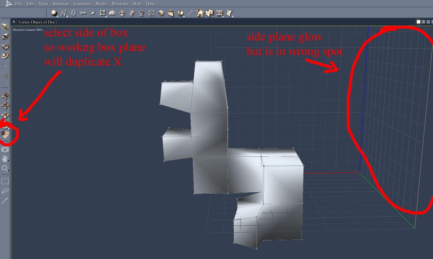

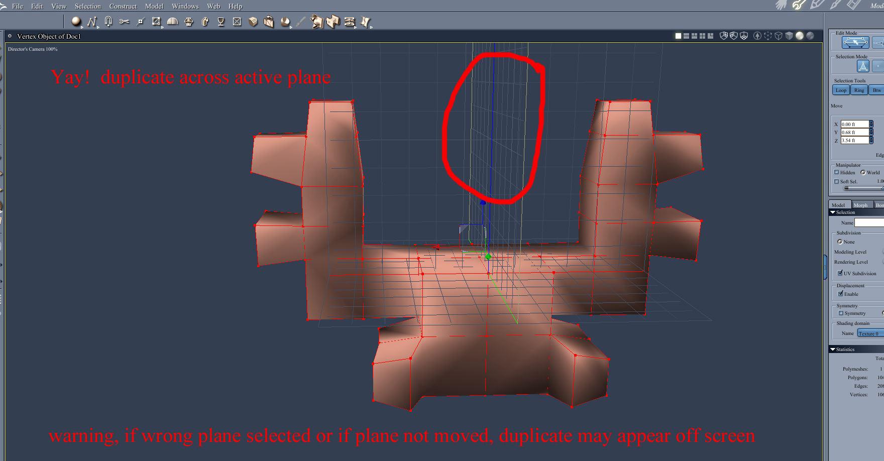

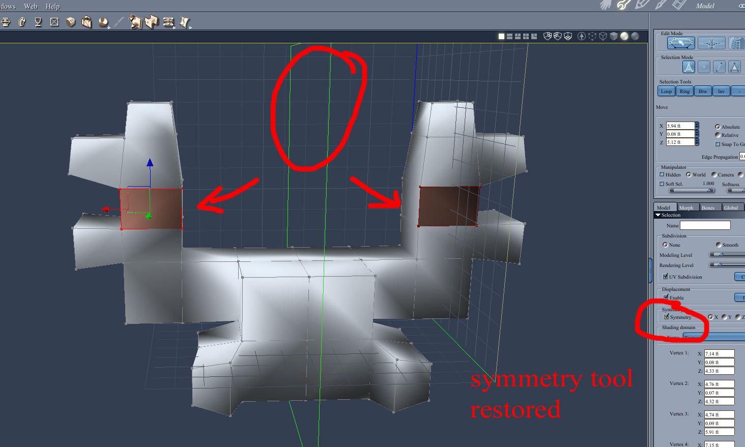

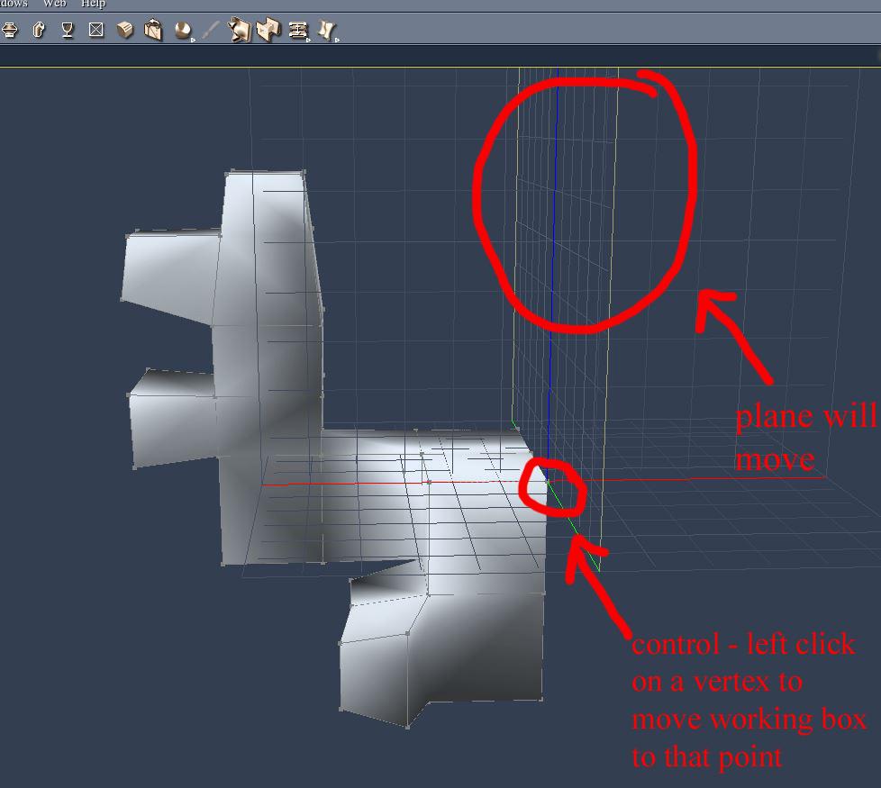

    Here is a handy way to restore symmetry.  It assumes that you have some vertexes at x=0.
    (save first, just in case something goes wrong)
    Delete the half of your object that you don't like.
    Select the plane of the working box that you want to do symmetry across.  Can select within the box along the left side menu.
    Send the working box to the edge of your model by using control-left-click to move the working box to a vertex on the x=0 part of your model.
    Use duplicate with symmetry and the modeler will ask if you want to weld the result.  Note - your answer to this might depend on how close your vertexes are together relative to the default tolerance.  You can always custom weld after an undo if you get bad results the first time.
    Remember to use the view menu to reset the workng box.
    Symmetry should work again.
    It is a little hard to describe so I have attached screen shots fom jj01a up to jj10a.  There is no 02 because there is a 01a and an 01b.
