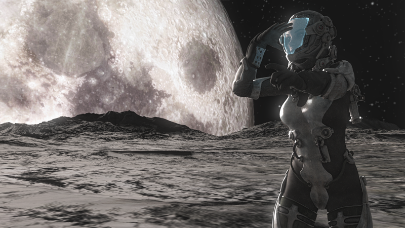

    Sorry - I should have been more clear. The following render is the WIP scene (before starting to play with some ground fog):
    The scene is lit by an HDRI and a little bit of emission from the visor. The BG is just the HDRI, only at -5EV compared to the rest of the scene (accomplished by rendering the view of the HDRI alone through the camera, adjusting the exposure -5EV, and setting it as a backdrop).

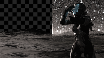

    In this next quickie, undercooked render of the scene, I've added a simple ground fog cube onto the right half of the terrain. I've also changed the backdrop to be a checkerboard pattern so that it's easy to see that the backdrop is being completely ignored for the areas where the camera is looking through the volume:
    Hope this explanation makes some sense.

  • @ mtl1
    I went back for a quick test, then I recall my temporal conclusion: the volume renders black (more precisely the volume doesn't even render) against Background in Interactive mode.
    When switched to Photoreal it renders "correctly". But it just ignores the Background image.
    So, @ algovincian, I can confirm your findings...
    343 x 305 - 42K
  • mtl1mtl1 Posts: 1,508
    Mythmaker said:
    @ mtl1
    Haha, IIRC from last night's test renders, mine doesn't even show the white parts... o_o
