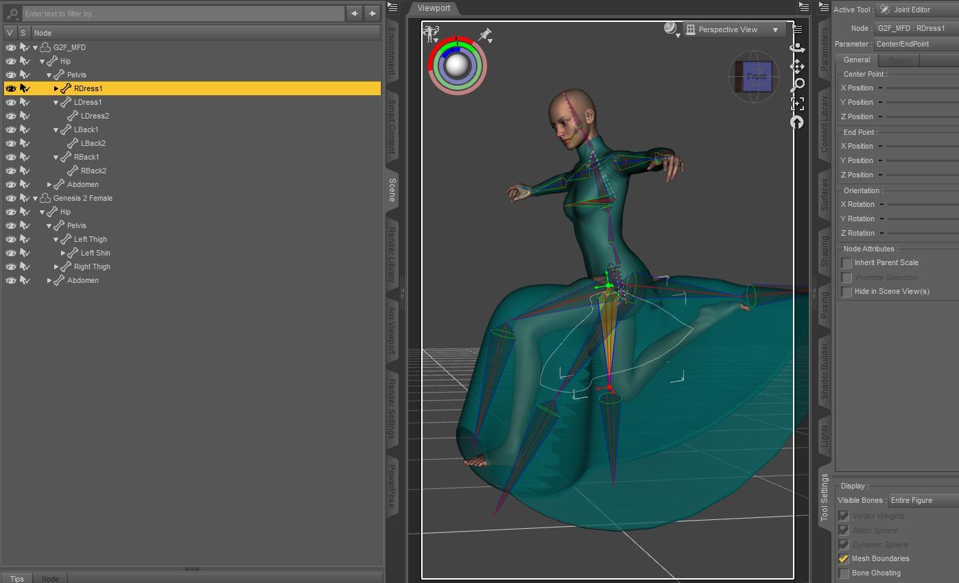

  • marblemarble Posts: 7,500
    This is what I mean about the lack of auto-follow. The screen shot has G2F with the Original Jumper Dress and G3F with the converted Jumper dress (converted using Wear Them All and the SY Ultra Templates). Bending the thigh shows that the original follows G2F but the G3F conversion does not.

  • WendyLuvsCatzWendyLuvsCatz Posts: 41,491
    I was only talking about how the clothes were made in regards to Poser dynmics, I do not have that dress sadly to test it using the keeping bones tutorial I linked.
    yes The SY autofit adds new bones, the tute I linked by her uses original ones
    but it may have joint controlled morphs too.

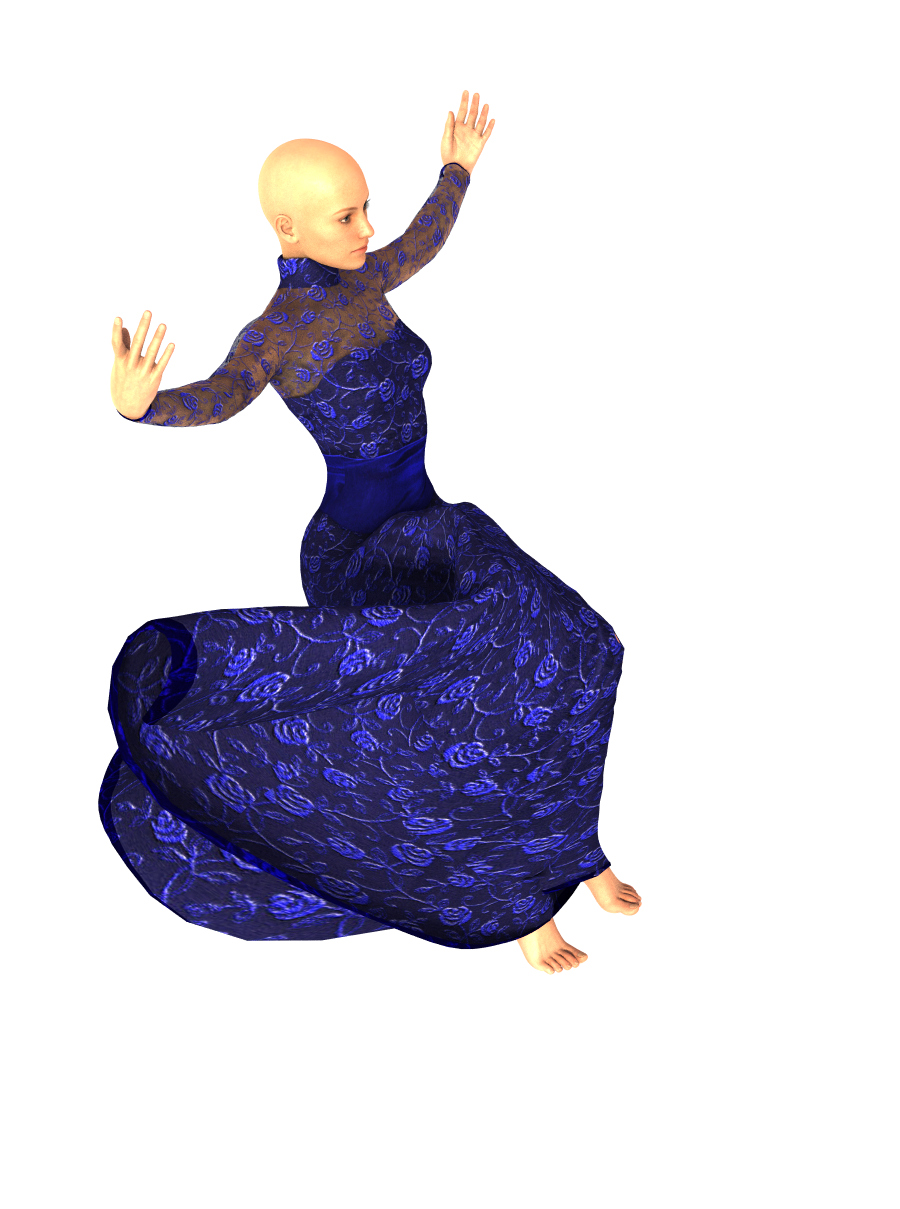

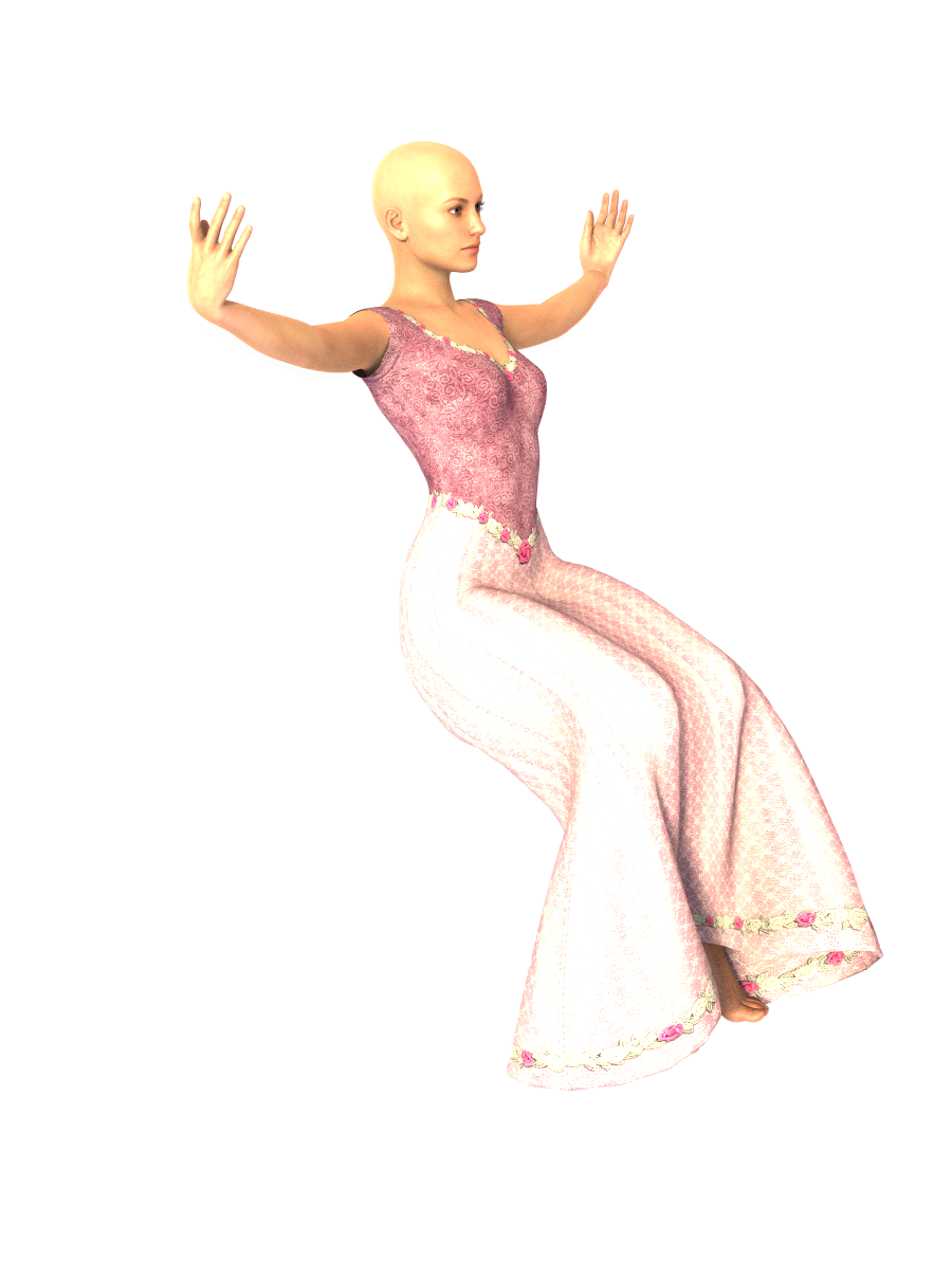

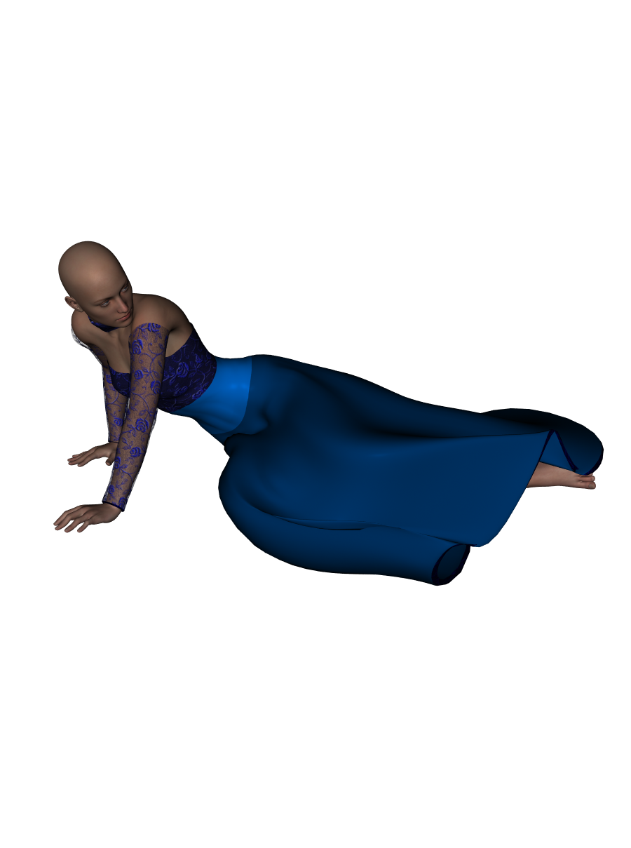

  • almahiedraalmahiedra Posts: 1,374
    edited March 2016
    marble said:
    I have a huge V4 wardrobe, a moderate Genesis collection and a quite large G2F content library. Now I'm starting to include some G3F characters - I've bought the morphs and a couple of sets (Bethany and Growing Up) and I'm starting to dress them up. I hoped to use my existing wardrobes with the help of converters such as Wear Them All and SY Ultra Templates. However, I'm having problems with poses.
    If I convert a G2F dress it usually fits nicely in T-Pose but when I try to have the figure sit, I just can't get the dress to match the thighs. If I use the bend handles (I think these are created by the SY Ultra product) the dress stretches and distorts horribly and does not conform to the legs at all.
    I did convert quite a few items a few weeks ago and ended up feeling pleased with myself and the conversion products but now, when it comes to using them in scenes, I find I may have been over-optimistic and I now have another expensive round of garment purchases ahead.
    Just an example: The Cute3D W-Skirt. Lots of morphs, many of which transfer across but comparing the movement with the dress loaded on G2F and the conversion loaded on G3F, I can see why Cute3D took the time to create a G3F version. The G2F conversion just doesn't work.
    Using SY Ultra produces a dress with leg bones names changed for independent moving dress (I am supposing this works like her previous products for rigging because I am not own the product), so dress didn't conform to legs anymore. Instead of, you are free to move your low par of the dress as you want do it.
    Something to help me using Morphing fantasy dress (which have handles instead leg) is set joint editor in tool setting tab to see the bones while I move them and understand how the skirt if changed. Of course, I next use wrinkler to improve the fall or add wind, produce an obj, and then a morph for the dress. If I had dollars, I would try the converter to dynamic clothe instead using wrinkler, to obtain the morph.
    900 x 1209 - 609K
    900 x 1209 - 374K
    900 x 1209 - 203K
    1398 x 851 - 98K
    Post edited by almahiedra on

    marble said:
    You mention two items that I was not aware of: Wrinkler and a Dynamic Converter. I found Wrinkle 3D here in the store but it is Windows only (I have a Mac) and also it would be another expense. I don't know the Dynamic converter you mention but I do think the Virtual World Dynamics converter looks like it might be a good investment. Unlike Optitex, it looks like you can move the cloth around with your mouse once it has draped. Again though, that is still in development and only - at the moment - for Windows :(
    https://www.youtube.com/channel/UCOpGh2GKgryXyMlbcTQ45dg
    Yes, we need wait for this.
    I forgot the no-mac problem. Maybe SY ultra bones would be better than MFD bones, remember that SY is the master of bones. Seeying bones highlighted for join editor can improve your use of bending in parameter tabs enough to don't need the dynamic step.
    I sent you a PM

    Point is not that products aren't gonna give good results when posing, point is that on some item pieces results may vary. Both clones and templates are created as helpers for people to make older items useful again, which doesn't mean all items will work perfectly, but most of them however will work well with these two products. This has been known with all previous generations of clones as well (created for Genesis and Genesis 2), where yes, clothes made for a particular figure (Genesis 3 for Genesis 3) are definetely to work best with it, which doesn't necessarily make it cheaper, especially if you have older items in your content folder you invested earlier and can reuse them instead of tossing them away.
    Cheers, V.
    Thanks to you and SY for adding to the discussion. The more I play, the more I'm finding that - as you say - some can be made to pose ok while others are more of a problem. I often wonder whether it would be a hard task for a PA to adapt their previous generation products and offer them at a discount to the owners of those previous products. There are some G2F and V4 items that are really nice but have no G3F equivalents.
    By the way - is the Auto-Follow that allows the skirt to bend with the leg not transferable during the conversion?
  • valzheimervalzheimer Posts: 519
    edited March 2016
    marble said:
    Autofollow should be automatic, unless you're adding extra bones. Depends how you convert an item - using a special template that adds extras or using a simple one that just clones Genesis 3 bones into a garment. That's where choosing the right template (shirt, dress, pants) from the dropdown (or just using - none) plays the part.
    Post edited by valzheimer on
    Thanks for the extra mini tute SY heart
    I must confess to not really using G3M & F so did not know
    I do use your keeping bones a lot between Genesis and Genesis 2
    I also have your rigging and morphing products too but use them more for adding bones to external clothing, my modeling attempts and draped Poser dynamics.
    yeah PA's put a lot of work into stuff so 90% of the time better to buy a version made for your figure of choice, I use the tools on stuff I cannot buy as it does not exist.
    marble said:
    OK - I convert with your Wear Them All and SY's Ultra Projections (which does add extra bones, I think). From the drop-down, I find the dress choices a bit confusing. For example - "short and wide" - is that a skirt or a dress? What counts as short? Knee length or just below the buttocks? And what counts as wide? A normal A-line skirt or something that flares out at the hips or anything that is not skin-tight?
    marble said:
    marble said:
    I warmly suggest opening "Read Me" folders on both products, lots of information there, Sickle even has the mp4 included and both have tutorials how to be used.
