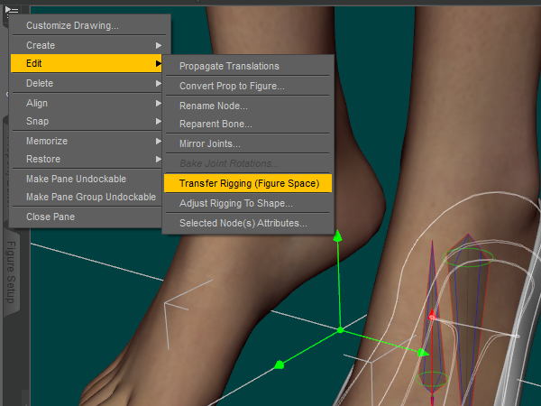

What is the difference when it comes to rigging for example a shoe to V4 vs Genesis in DS 4.5.n.n?
I've follow the same procedure I used on Genesis but get the following error message when I try to Transfer Rigging (figure Space) in the Joint Editor :
Edit : Just to clarify, I did select the Victoria 4 figure AND the new shoe figure before attempting to execute the Transfer Rigging command...

  • Richard HaseltineRichard Haseltine Posts: 111,468
    Neither Victoria 4 nor her clothes are TriAx figures (they don't use weight-mapping, and the Transfer Utility uses weight-mapping to project the source figure's rigging into the target figure or object). If you want to use a legacy figure as a donor for clothing to fit it you need to use the Figure Setup pane - copy the selected donor figure (pane menu), import the OBJ into the pane (not the scene), drag it into the hierarchy, remove (or add) bones as needed, check Modify Select at bottom-left, click Create.

  • niccipbniccipb Posts: 483
    Hi bringho...
    The 'Transfer Rigging (Figure Space)' feature is only for Tri-Ax weighted figures. That's one of several tool features created for making the rigging of Tri-Ax figures easier than legacy parametric figures.
    There is no tool to automatically align the bones of a parametric rigged figure that I am aware of.
    The Figure Setup pane relies on the mesh groups or face regions to position the bones, and shoes typically only have a few groups or regions, so all of the additional bones will 'clump' around the objects center.

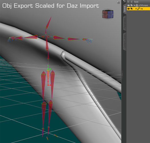

    I've changed the geometry reference on line 7 and 275 of the 'V4 Dev Foundation.cr2' to:
    figureResFile :Runtime:Geometries:xTreemeHeels:xTHPumps:xTHPumpsLzero.obj
    And saved the cr2 as 'xTHPumpsL.cr2'.
    When I loaded the 'xTHPumpsL.cr2 the geometry was scaled as seen in the first picture. In that case my geometry was scaled for Daz and it is roughly 24000 % of the original size which is the difference between saving as Daz (1 unit = 1cm) and Poser (1 unit = 8ft).
    So I created another obj export scaled for Poser and the result is seen in the second image. No geometry is to be seen at all?!?
    Any idea as to what is the solution to this problem?
    Another question, what is the reference of the white line pointing backwards away from the hip bone when it is selected?
    Make sure you change the option for groups to Use existing if you export using the Poser preset.
  • bringhobringho Posts: 241
    Thanks Richard!
    Not totally obvious, but that's what I did wrong.
