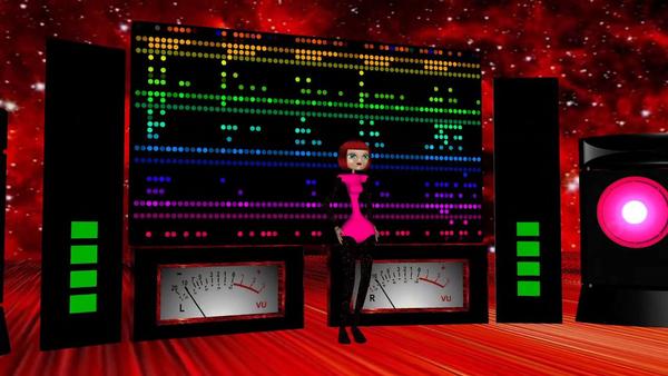

    here i applied the animation to the ZScale channel of a black primitive-plane that masks some of the LEDs
    when the sound-level is near zero, the mask is scaled 260% and covers the whole column of LEDs
    when the sound level is maximum, the mask is scaled 0% and doesnt cover any LED
    the needles of the VU meters get their YRotate rotation animated between 42 degrees and -42 degrees
    for now there's only 1 animation channel even if the music is stereo, but this will change in the release

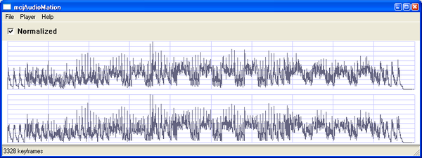

  • mCasualmCasual Posts: 4,607
    edited October 2012
    now in stereo

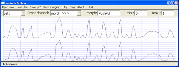

    so, first picture: i run the Windows app named mcjAudioMation
    i select and load an audio file
    i export the processed audio as a .dsa daz studio script
    second picture i select the VU Meter's needle
    i run the script that was produced in step one
    i adjust the multiplier and offset so that, the needle's YRotate angle will vary between +42 and - 42 degrees
    the animation comes from the Left channel o f the audio
    1193 x 664 - 51K
    800 x 300 - 16K
    Post edited by mCasual on

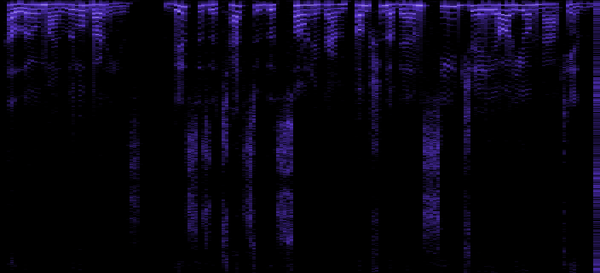

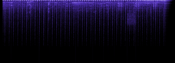

    spectrogram or sonogram for the demonstration video
    2nd image is the sonogram for a 6 seconds speech ( synthesized voice ) and uses a logarithmic scale for the power/brightness
    3rd image is log-scaled sonogram for the demonstration video

    i think the programming is completed here's the UI
    not very cute but it should work on all Windows version since 1995
    800 x 300 - 13K

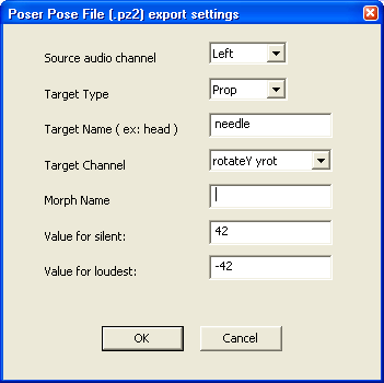

    i moved the Poser Export Settings to a dialog window, it's neater this way
    later i may post an update with some speedups

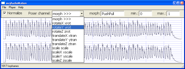

    in poser, if you animate a character's abdomen, then save this as a pz2
    then using notepad you compare it with the pz2 produced by mcjAudioMation, you should be able to figure what's the problem
    for example, maybe the proper name is "rotationY Twist" instead of "rotationY yrot"
