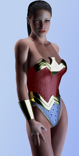

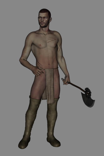

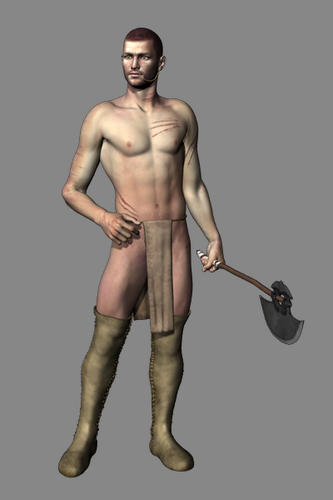

This is for RKane, who asked how to improve his lighting in order to sell a product, and for anyone else with the interest. I always feel a little uneasy doing public tutorials, because I'm usually instructing on something that other people are better at than I am. The fact is, though, that those people aren't always going to have the time or interest, and I can still help a beginner without being, well, mattymanx. ;D For some examples of very advanced and gorgeous lighting I point you to his deviantart page. For now, let's look at lighting in DS4. This should work in DS4.5 as well.
The picture attached to this first post represents the DS4 default lights and render settings. Notice how the picture looks gray and dull. I've heard people claim you should offer a render of the default lighting with a product in order to prove that it works. This is a terrible idea for several reasons. The most important is that nothing looks its best in default, and renders sell product. The second is that default lighting can mask normals direction problems in a mesh that make it totally unusable under UberEnvironment lights. Third, you don't want to even pitch to customers who regularly render under default only, because you don't want your name on the credit lists of renders that you know are going to look terrible. That's not a good advert for your product.
The character is SAV's Spartacos, the figure is a Genesis character dialed from D3 and M4 with one of RAMWolff's free faces, and the pose is by DZheng. All the goodies he's wearing are by me.
400 x 600 - 66K
«1

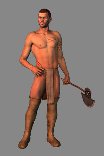

    Here's a copy of the lights I'll be using for this tutorial. They are numbered and I will refer to them thus.
    This will be the most useful for lighting a single character and/or a small scene at close or mid-range. Lighting an entire large scene, as artists like Stonemason must to sell large prop sets, is graduate material and will not be dealt with here.
    Let's start with Set 1. This a simple three-point light setup with two diffuse lights from different directions and one specular light from the front (the direction the camera is pointing). These are all distant lights, so they affect the entire scene. One diffuse light is set to cast shadows.
    Separating specular lights (which determine shiny highlights on your items) and diffuse lights in your scene gives you more control over the direction and type of your highlights. If you just leave the main lights at "on" instead of diffuse, they will cast highlights from two different directions, and sometimes that's not going to look right. The same is true with shadow casting. Don't turn on shadows with every light unless your scene actually calls for weird multi-directional shadows.
    You can see that this is an improvement over our default lighting, but it looks harsh and a little odd. This effect is one you can exploit deliberately if you want to make, for example, Boris Vallejo-homage fantasy renders, but you don't want it for most scenes.

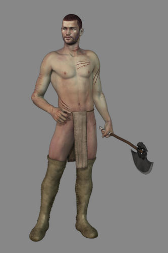

    400 x 600 - 78K
    edited September 2012

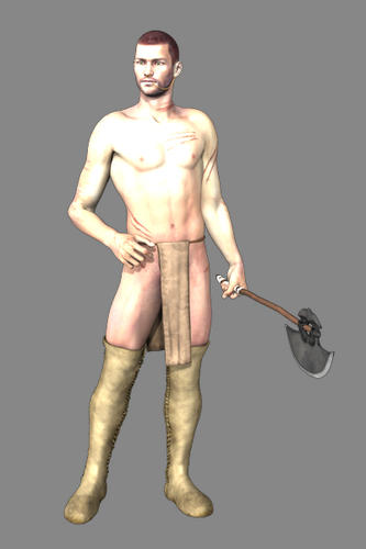

    The biggest difference between the above and the solid-looking, strangely more realistic renders you both see and want to have is omnifreaker's UberEnvironment lights. These are found under Light Presets-OmniFreaker-UberEnvironment 2. In the first render below I have added a single !UberEnvironment2 Base light and set the quality to 4XHi in the settings on that same section.
    Of course this is much too bright! In the second render I've turned the Uber light's intensity down to around 39% in the parameters tab. Look at the edges of the figure in particular compared to the previous post's renders and you can see how much more depth and dimension this gives us. Yes, it takes much longer to render, but believe me, this is VERY worth it - and it doesn't take longer than adding the number of spotlights you would need to fake global without it. This is Set 2 in the lighting package.
    This gives us an okay look for bright sun renders or other ones where you mostly want to draw attention to the character and/or outfit, not their environment or the entire scene. It's not great for action or seductive or dramatic looks. Still, this can sell a product all on its own if it's in a good closeup shot.
    Notice that I set up the non-Uber lights before I added the Uber light to the scene. This is because I'm using it as fill and the others for dimension and directional shadows. Uber lights won't give you those nice long shadows and they do not add any specularity on their own, so using them by themselves is not a good idea. I've heard great things about UberSpots, but I don't have those yet, so that will have to be for another day's tutorial.
    400 x 600 - 82K
    400 x 600 - 87K
    Post edited by SickleYield on

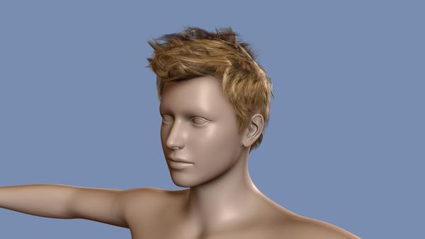

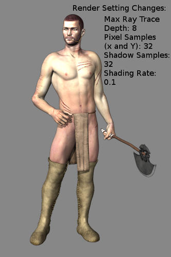

    Let's not neglect the render settings.

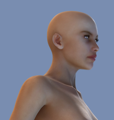

    This render uses the same lighting as the last one, the UberEnvironment at 39% with the three distant lights, but I've turned up the pixel and shadow samples, added more raytrace depth, and greatly reduced the pixel shading. The difference may not seem obvious until you look at the eyes, the lacing, and the edge of the axe. See how much sharper and clearer they are?
    At 400x600 this may not seem like a big deal, but at 800x1600 or 700x910 (Rendo and DAZ's main promo sizes at the moment, respectively) it's huge. This will greatly increase your render time, but it can also be the difference between acceptance and refusal (both by brokers and by customers).

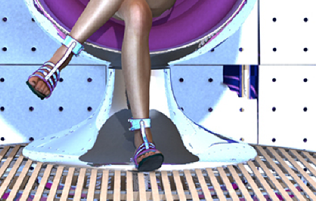

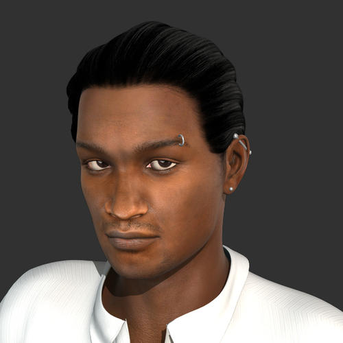

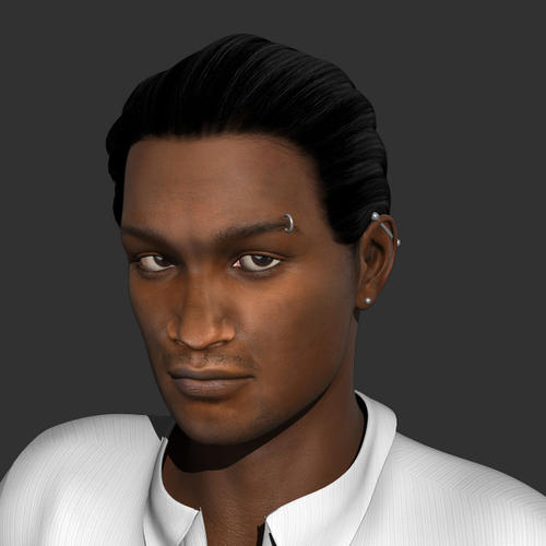

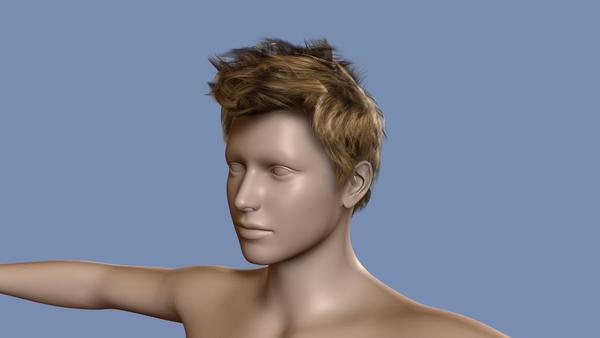

    Okay, here we go! This is another Genesis character dialed from M4, M5, RAMWolff, and DieTrying conversion morphs. The skin is Benjamin from DAZ, which came with one of the M5 bundles and has nice HSS shaders. The jewelry is mine with shaders by Fisty/Marieah, and the shirt is mine textured by Marieah. The hair is Pure Hair Sleek from DAZ.
    Both renders use the "enhanced" render settings from the previous post (shading rate .1, etc.).
    On the left or first one, depending on your screen, we have Zigraphix's one distant (set to "on" and raytraced shadows) and 25% Uber. I left the settings on the lights alone otherwise. This looks nice. I would not hesitate to use it on a promo when I was in a hurry and did not have time to let the render go for hours, and in fact I've got a similar preset saved for test-rendering as I work.
    On the right or second is the same thing with the Uberlight turned up to 39%. The distant light shadowcaster has been turned down and set to "diffuse," and another one from the same direction added and turned to specular. I have added the blue/orange spots from right and left again with shadows off. There is a point light to the right of the character's face set to specular with no shadows. I think this is a little more realistic with the less opaque shadow and subtler highlights, but there's actually less difference than I thought there would be, and actually I think it is a little bleached with the Uber that high.
    There's less difference between them than you'd think resource-wise as well. The first one took 3 minutes 50 seconds on a system with 16gb RAM and an Intel i7 6-core and the second took around 4 minutes 30 seconds. You might do better with a similar system if you didn't also have another DAZ instance and Blender open in the background, the way I usually do. ;)
    I think the reason is that both have an Uber light, and adding additional spec/diffuse lights with no shadows doesn't actually add much render time.

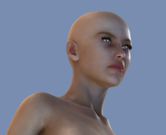

    Here's one with the second lighting shown above but the Uber light turned down to 25% and the main shadowcaster up to 75%. I think it helps eliminate some of the bleaching while keeping the benefits of the extra speculars and dimensional lights. This also took about four and a half minutes at 600x600.

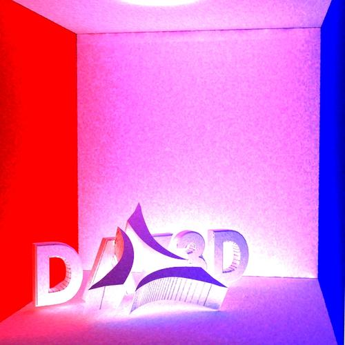

    I know we also have the ability to set up ray-traced lights with color bleed (requiring custom cameras, as well) but I haven't used them much. There's a sample scene that comes with DS 3 and 4, though.
    Really? I haven't played with color bleed! What does it do?
  • zigraphixzigraphix Posts: 2,787
    Here's the test scene, rendered out. Look in the default Studio library, wherever you have it installed, under Scenes/Shader Mixer.
    618 x 618 - 275K
    Huh. Interesting. I haven't seen that rendered with much. It looks worth experimenting with!

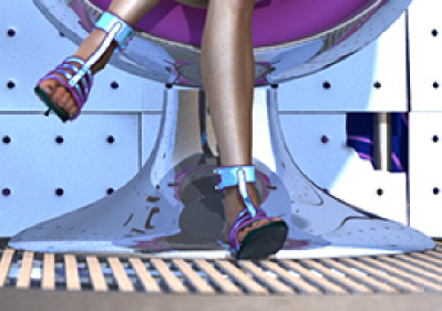

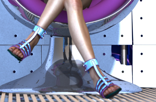

    I showed you the thing back then. I had problems with surfaces inter reflecting and had a big grey spot
    Upping pixel samples and max raytrace helped

    Last example. 5 light setup with UE and ditch river HDR and custom SSS shader and default Genesis texture Lana. Shading rate was at 1 and in fact all settings were at DS default, but for render size which was at 1920x1080
    This is impressive, when you say 'custom SSS shader is this a shader you built your self or settings for one availble.
    Thank you
  • Takeo.KenseiTakeo.Kensei Posts: 1,303
    You're welcome Takeo!
    Oh, this one, right! Pity the pictures are dead on the old forum now, otherwise I would have remembered better...
    There is a workaround here to get pictures in the forum archives. Use Foxreplace it works great
    And I often think of that custom SSS of yours since it's so cool, I think these are new Lana renders in your latest post here, aren' they? I don't remember them from the old thread.
    Thanks :). The Lana renders are rather old. I did them at least 6 month ago but I never posted them. I didn't work a lot on the skin shader since then.
    I don't think hair AO is worth bothering with for that exact reason, usually. That's a neat render. I like the attention to the pockmarks and details on his skin.
    Nice one Muskat. I didn't see this one when I browsed your gallery. I tried the Fantom trick and it seems to speed up rendering in some case. I'm still unsure about AO on hairs. There are some case where I think that it mixes well with the render
    There's another thing I forgot that adds massive render time - Depth of Field!
    Agree with that but it's worth using as renders are better.
    Thank you
    Thanks. It's a custom built shader by myself. I only posted the good ones. You haven't seen the buggy ones ;)
    Post edited by Takeo.Kensei on
  • scorpioscorpio Posts: 8,533
    Thanks for the reply. Iespecially like what the shaders does to the area around the ears.

    There's another thing I forgot that adds massive render time - Depth of Field! This promo render for an upcoming product took three hours AT the lower pixel sampling at a resolution of 800x1600: http://sickleyield.deviantart.com/#/d5fcn02
    You can fake or add DOF in postwork, but I don’t like to do that.
    I don't know why, but the scripted dA links don't work for me - I guess it's this render you were referring to? http://sickleyield.deviantart.com/art/SickleFuse-Unearthly-Realms-Necromancer-328114802
    As for me, I too use DOF almost all the time (I am too lazy to fake it in postwork - that would require rendering z-depth maps an' stuff), but at my settings, the increase in render time isn't that high. I even neglect the common recommendation to up pixel samples to 12 for DOF because my DOF is generally very subtle, and even when it's not, I like some grain in it. http://mustakettu85.deviantart.com/art/For-a-moment-251475608
    It would seem that the more HQ the settings are, the quicker the time jumps up with DOF added (especially with raytraced shadows).
    I might clone out a clip of a plant with another plant off to one side instead of rerender the whole thing, for instance, but clipping of clothes vs. body means a redo
    More often if I just can't afford the render time I'll render to .png and postwork in a gradient or simple pattern backdrop, since that negates the need for DOF. This way it's obvious that's what has been done to both me and the customer and is not a "trick" to make a product look better than it is.
