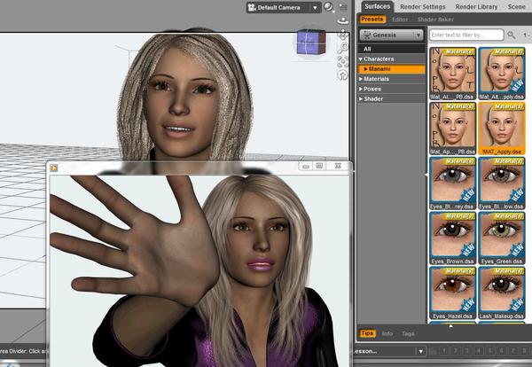

only teeth color turn red when render
kitakoredazkitakoredaz Posts: 3,526
I tried so basic animation by daz 4 only, pupettief face pose, animate light some animation brock , then just cameramove,
it seems well for me as first test ds 4.5 animation,,
(actually a few kee frames change face ugly, face pose? removed all skin from face,,
but I delete the frames and apply face pose again then corrected it)
but then render every image, there is one odd thing.
the actor teeth color turn red . I never see such color teeth in default setting render.

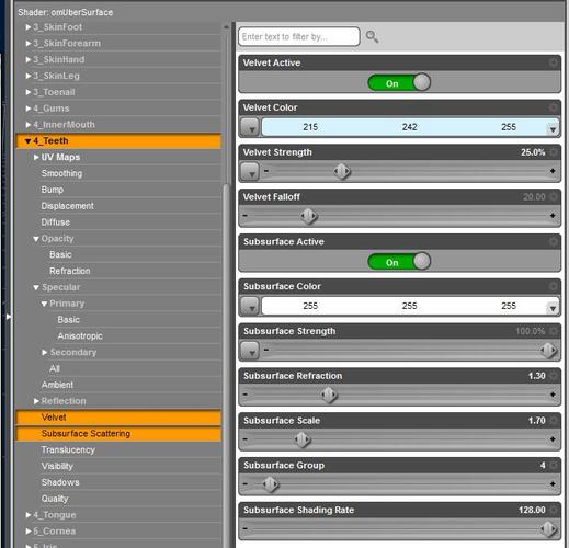

  • jestmartjestmart Posts: 4,449
    I have seen a few badly done material presets for both the Human Surface Shader and Ubershader. The problem is usually a deep red color is applied to the subsurface scatter or the velvet channel settings for the teeth.
  • kitakoredazkitakoredaz Posts: 3,526
    thank you jestmart ;-)

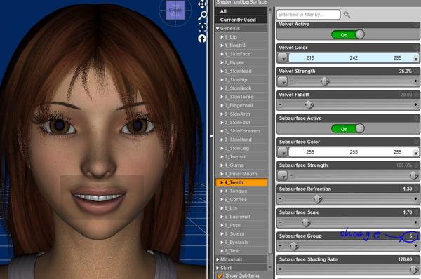

    I tried to correct setting of teeth surfaces,, so I off and on ,about some parameters which I can understand thet means
    but I could not define which parameter .
    then I checked again as you said now,,
    yes,, thank you,, much,, if I check off sub surfaces active it seems to be normal.
    there are "color" "strength" "refraction" "scale" "group" and "shading rate" about sub surfaces,,
    then If I change "group" value, the teeth turned white,,
    the assigned number cause only red teeth ^^:
    if I set "4" teeth must turn red,
    other number seems OK,,
    but I do not understand these parameter means at all,^^;
    is there any good document about these parameter?
    I studied about some main parameter of material ,,but I do not understand
    about "Fresnel" "velvet" and "sub surfaces" (and Trunslucency Fantom too,,)
    those setting is for some shader only ?:coolhmm:
    984 x 652 - 119K

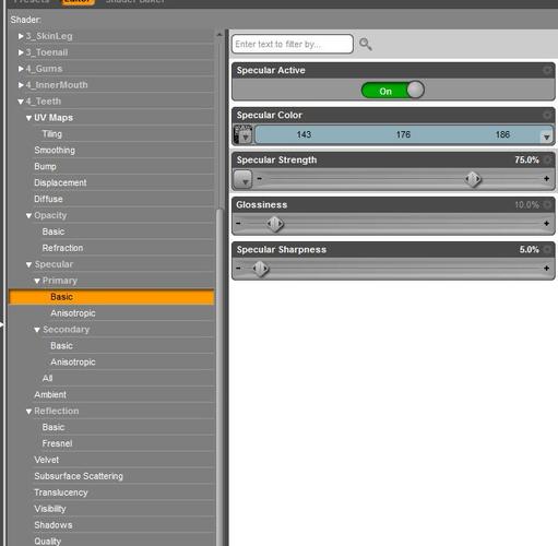

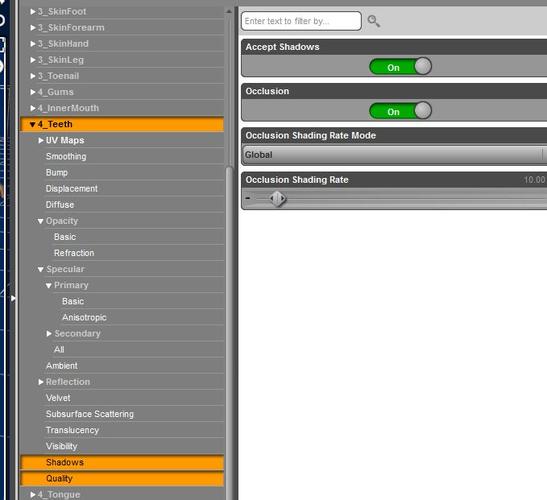

    What are ALL your settings for the Teeth?
    thank you,, but it seems imposible every setting copy, maually.
    and there was so many category,, and I understand now,,
    this character preset use ubersurface shader,, (ah,, I understand,, it is shader,,)
    so I stuck only active parameter.:gulp:
