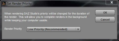

    Interestingly I wrote a DS plugin a few months ago that lowers the DS process priority during a render (and restores it after the render is finished). Did it mainly because I got tired of having to go to the task manager to lower the process priority by hand.
    Didn't think it had any commercial value and wasn't really keen on dealing with people that would complain renders would take slightly longer, so it's just something I've kept to myself (well one other beta tester). But it's been pretty handy.
    485 x 170 - 28K
    There would be a HUGE market for it.. please sell it!
    I had to dig up this thread today, Thanks for the instructions, Adam, worked great. A nice little easy to use script would be even better though. =)
    I'd buy that script.
