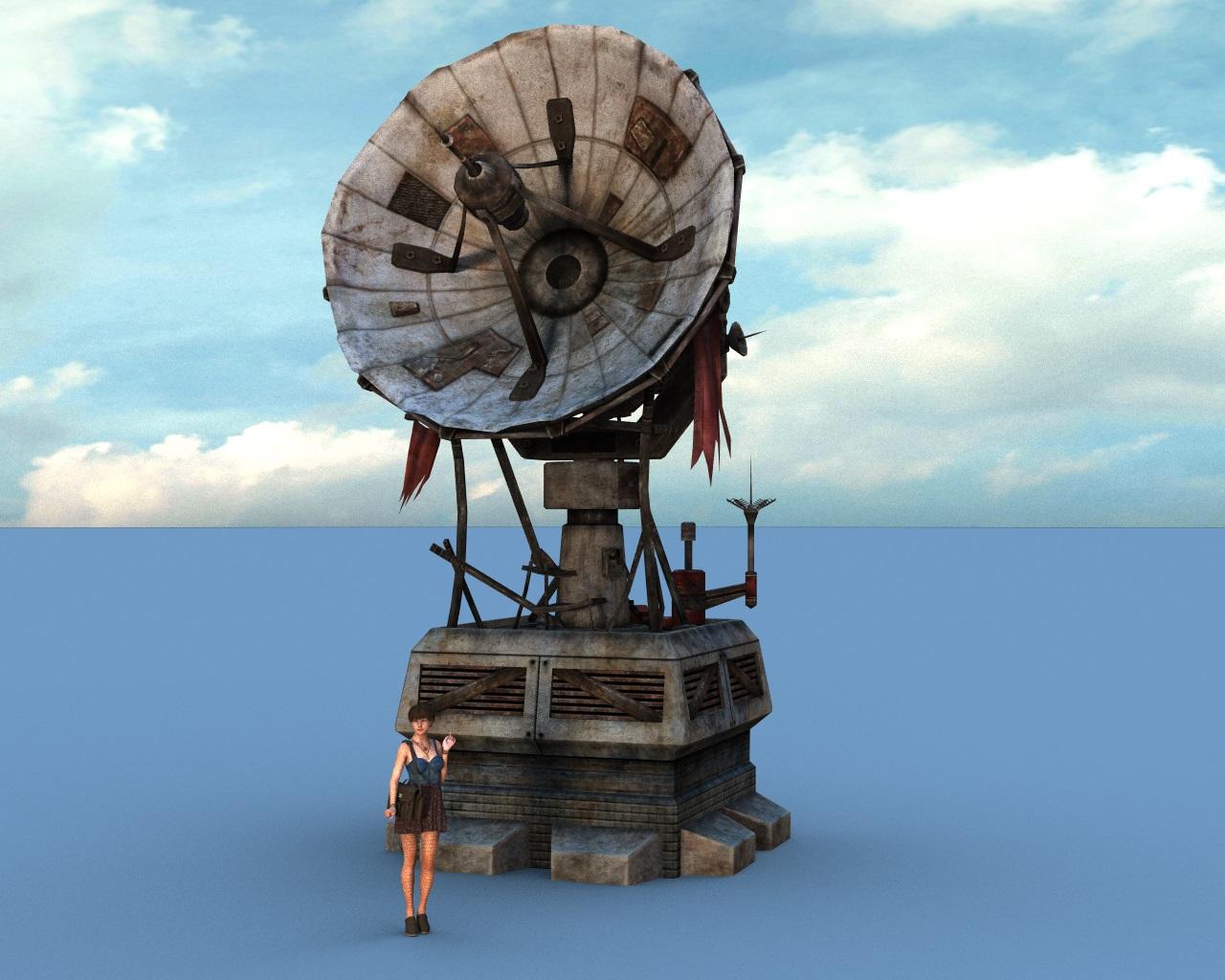

    I have tested different exporting options from Unity and so far COLLADA Exporter for Unity 5 works the best.
    It exports whole scenes as well as the selected items only. All textures are preserved, so it is easy to use exported items  in Daz Studio.
    It looks like the scaling is consistent between differents assets, I have tested.
    Below is a quick 3Delight render in Daz Studio of the free Satellite Dish / Communication Tower by StarCity Designs
    exported from Unity as a Collada (.dae) file. I have added Genesis 3 Female for the size comparison.
    1280 x 1024 - 322K
    Post edited by Artini on

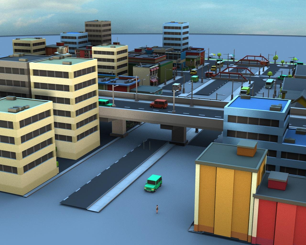

    ... and another Daz Studio render of Simple Town - Cartoon Assets by Synty Studios
    exported from Unity 5 as a Collada file.
    1280 x 1024 - 446K
  • Thank you for the amazing examples, Artini!

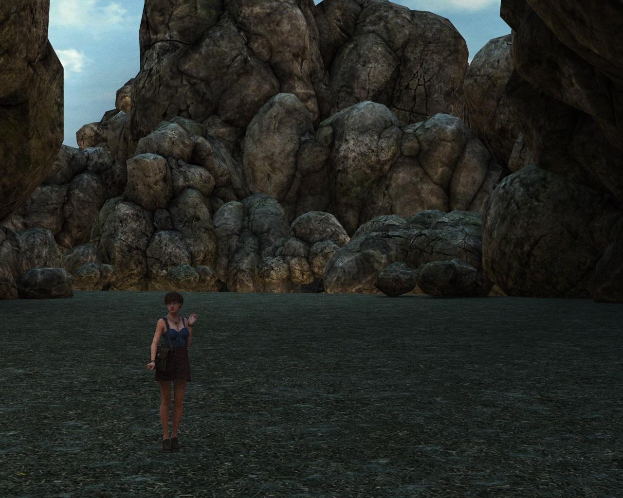

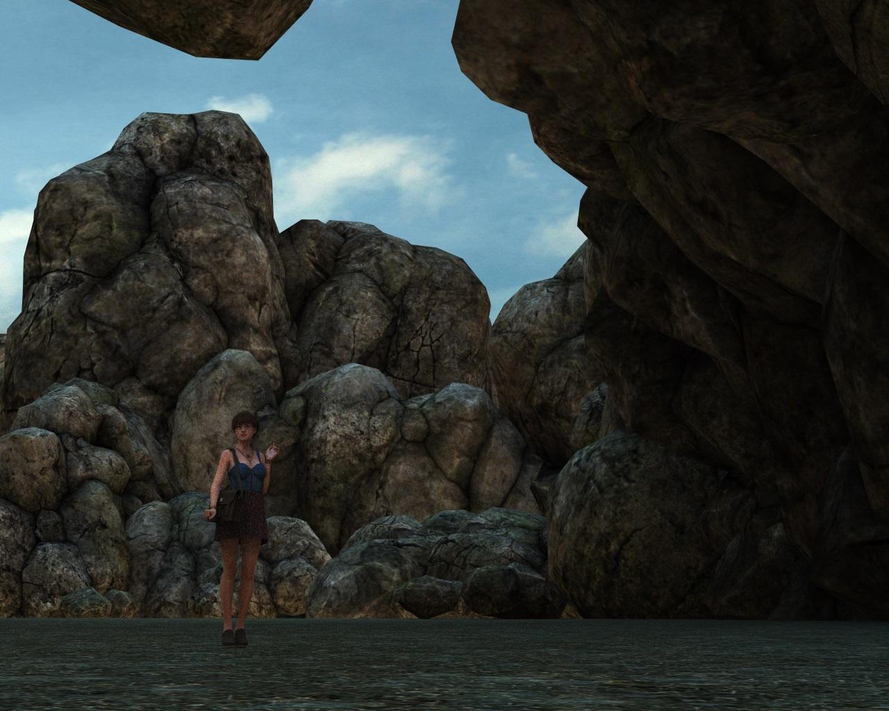

    Another example - Genesis 3 Female and the freebie Rock & Boulders by Manufactura K4 from Unity Asset store
    rendered in Daz Studio.
    1280 x 1024 - 447K
    1280 x 1024 - 359K

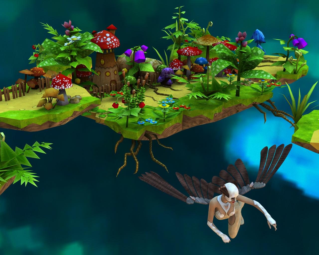

  • ArtiniArtini Posts: 10,904
    edited April 2016
    Yet another example rendered in Daz Studio: http://www.daz3d.com/eruanna-for-giselle-6
    and the freebie from Unity Asset store: Mushroom Land by Manufactura K4

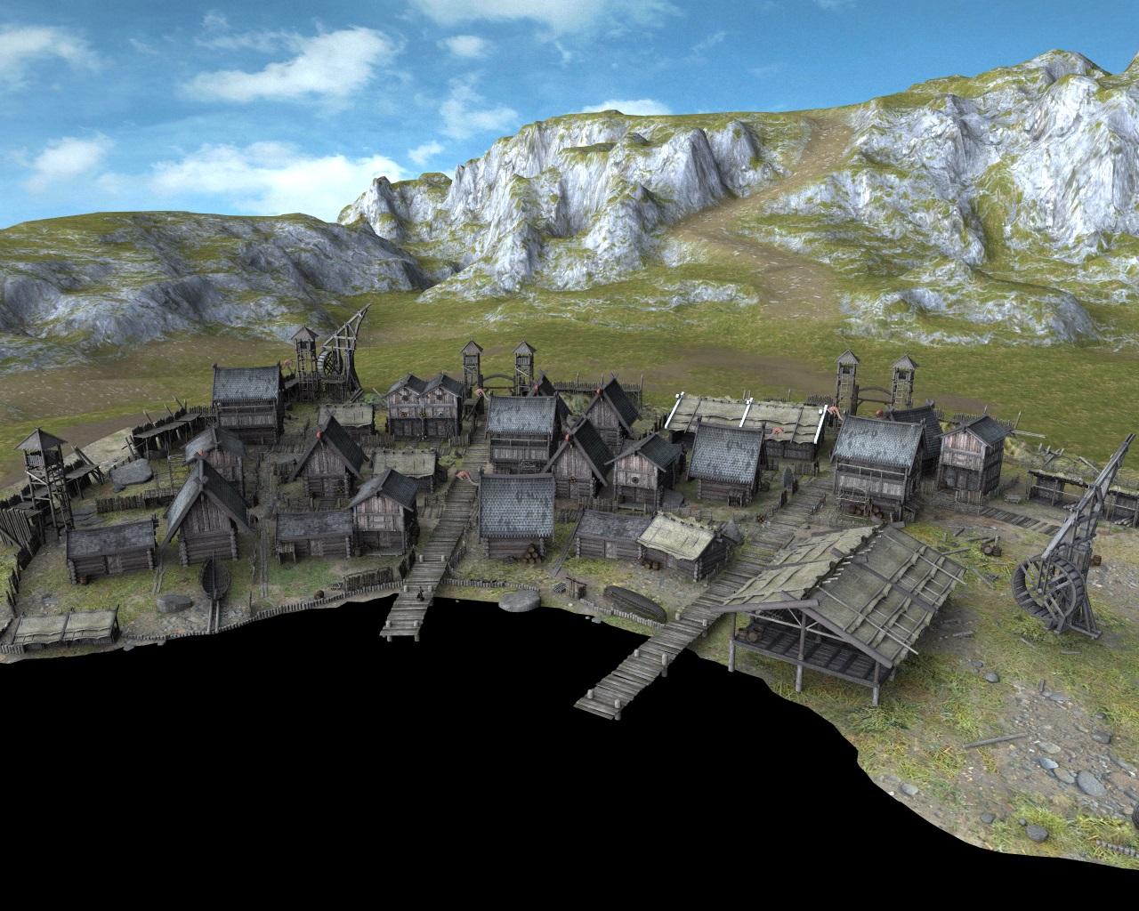

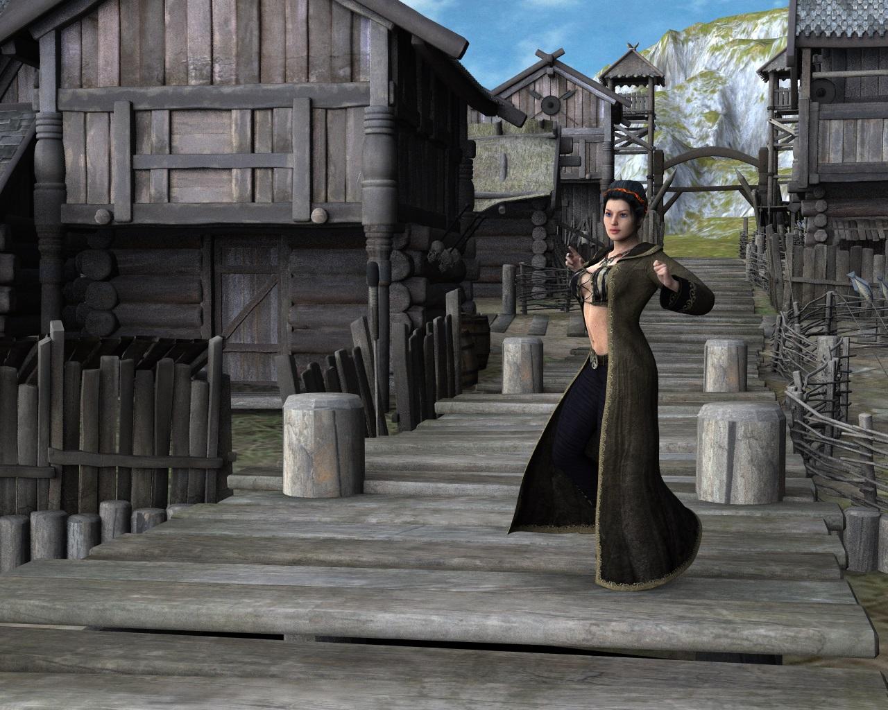

    For now yet another example rendered in Daz Studio: http://www.daz3d.com/lilith-6
    and the freebie from Unity Asset store: Viking Village by Unity Technologies
    1280 x 1024 - 504K
    1280 x 1024 - 475K
