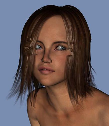

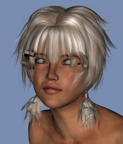

I'm seeing a rather odd issue with the Riley for Stephanie 5 figure. If I apply pretty much any hair to the model, it distorts in the vicinity of the eyes. The problem does not occur with Stephanie 5, or Victoria 5. The attached images show the problem occurring with Pure Hair Nightlife and Chelsea Hair.
This occurs with DAZ Studio 4.5 64-bit on MacOS X 10.8.1. I haven't tested it under other configurations.
Anyone else seeing this, and is there a fix?

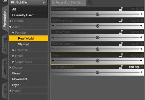

    On your Parameters tab use the Options menu and make sure "Show Hidden Morphs" is turned on. If the Riley morphs are set to auto-follow then morphs will be created in the hair for them.
  • bytescapesbytescapes Posts: 1,932
    "Show Hidden Properties" revealed a 'Riley' morph under Actor:Female:Real World.
    Setting this to 0 changed the shape of the hair slightly, but didn't get rid of the distortion.
    There don't seem to be any other Riley morphs injected into the hair that I can see, although there are some Stephanie 5 morphs. Fiddling with those doesn't seem to resolve the distortion issue either.
    Thanks for all your help. Is there anything else that I need to know or try before I write this up as a bug report?

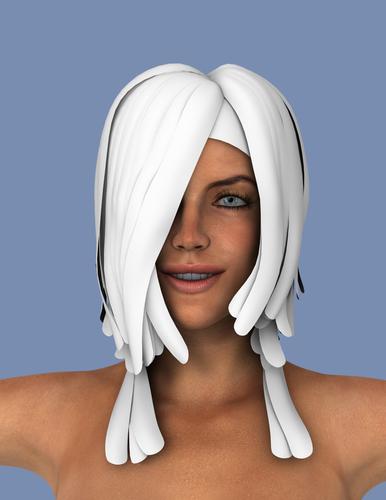

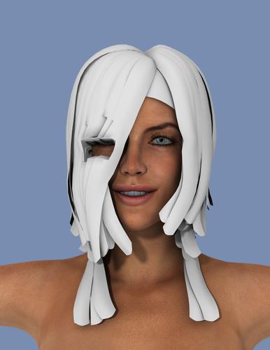

    Select the hair in the scene tab and try zeroing out one or more hidden morphs in the section Actor->Head->Face->Eyes. I had a similar problem with PH Crazy hair on a model that was a modified Riley (other dials spun, too). I changed PHMEyelashesHideLayer from 100% to 0% to solve my problem. I'm attaching photos of the untextured hair, because that makes the distortion and the fix very visible.
    Note that I didn't have this problem with this hair on Stephanie 5. The problem showed up on Riley.

    This looks like the eyelash 2nd layer is hidden.
    To do this it collapses the eyelash 2nd layer into the head.
    This morph needs to be set to not autofollow as any partially covering the eyes will be effected by it.
    I assume only the character mentioned has the morph dialed.
    Quick fix would be to locate the morph on the hair and dial it back to 0.
