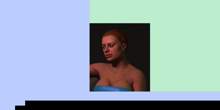

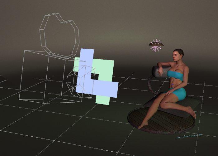

    Here's a screencap showing the camera I'm reusing, with the "two Ls" gadget blocking out the parts I don't want to re-render. I used two different pastel-ish colors here, for illustration purposes, but any color would work.
    The surfaces of the L objects are using the standard "DAZ Studio Default" shader, with Diffuse strength at 0%, Specular strength at 0%, and Ambient strength at 100%. (It's the kind of surface setup you'd use on a sky dome.) This leaves very little for the render engine to calculate, so the blocked-out areas render very quickly. I also set the L objects not to cast shadows (again, like a sky dome) to pick up a little more speed.
    For positioning convenience, I parented the two L objects to the camera. I zeroed out their rotations--- except for rotating the second L in the Z plane by 180 degrees. Then I translated them around until I had blocked off everything but the spot I wanted to re-render. They ended up quite close to the camera, as you can see.
    700 x 500 - 34K
    Post edited by merc-daz3d_c669b168a9 on
  • edited August 2012
    Here's the resulting "spot render."
    Since the changed area was near the top, I didn't even have to let the render run to completion. (Although I still wasn't fast enough to stop it right after the important part was done!) This is using the default "Bucket Order" of "Horizontal" (which is set in the Advanced options of the Render tab.) If I needed to re-render an area near the lower left of the image, I'd use "Vertical," which works its way across in vertical columns. The "Spiral" bucket order works outward from the center.
    For a spot render in the lower right corner--- oh well, I guess I'd be waiting for the full render. But not as long as I would be if I didn't block out the rest of the scene...
    700 x 350 - 8K

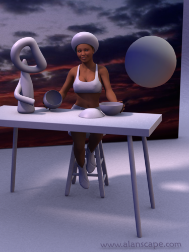

    Sub-Surface Scattering

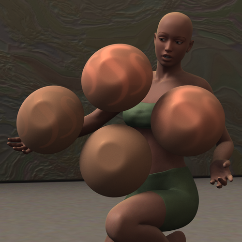

    After a few months of occasional attempts at using Sub-Surface Scattering, I finally got around to setting up a simplified experimental rig, to try to isolate what some of the different settings actually do.
    First off, credit goes to RawArt for providing some good starting settings. It sure helps to have some kind of effect visible before you start spinning dials at random... 8^j* I also snagged a copy of Dimension Theory's Interjection product during last month's PA sale, which saved me the truckload of hours it would have taken to construct my own SSS maps for the 4th gen figures--- and provided another set of UberSurface settings to experiment with.
    Attached are a sample render of "Four Levitating Bowls and a Bald Vicki," plus the goofy SSS test map I used for the surfaces on the bowls. (If you want to use the latter for your own experiments, click through to get the original version without the extra level of JPEGgery introduced by the forum previewer code.) All four bowls use the same starting UberSurface settings, with different sections shut off.
    The bottom bowl has no Ambient and no SSS active. The Diffuse is at 100%--- more on that in a bit.
    The left bowl (viewer's left) has Ambient on but still no SSS, with Diffuse at 95%.
    The right bowl has SSS on, no Ambient, and Diffuse at 95%.
    Finally, the top bowl (viewer's left) has Ambient on, SSS on, and Diffuse at 95%.
    Next up, dissecting the settings...
    512 x 512 - 21K
    960 x 960 - 859K

    On the "test bowls," I left most of the UberSurface settings at their defaults--- in the attached composited screencap, a bunch of the subheadings have been collapsed. Those values are as the base UberSurface load initialized them. Proceeding from the top,,,
    The Diffuse color is a jpeg, medium beige, with a little multi-color Gaussian noise added, and multiplied by a peachy [255,238,221] off-white. It's a nice utility skintone for when I want to isolate the effects of settings--- the painted-in details in a good skin texture make those harder to pick out. Why 95% strength? Because in early experiments, highlights were getting "blown out" (i.e., kinda over-exposed looking) when I added in Ambient and SSS. Depending on the skintone/lighting/glossiness you're using, that dialing back may not be necessary.
    There's just a smidgen of texture in the Bump channel: a little Gaussian noise again.
    Went a little bit shiny with the Specular, for a slight ceramic effect on the bowls. On skin, the UberSurface defaults are pretty plausible, but this is something you'd adjust according to the needs of the image.
    This is a fairly bright & saturated Ambient color, but it's dialed way down to 4.2%. It's also applied only in the areas designated by my SSS map. Again, you have a lot of creative leeway here, depending on the skintone and desired effect.
    Velvet is used here to emulate looking through a semi-transparent ceramic glaze layer near the edges of the object, where the surfaces are almost turned away from the viewer. So you'd be looking through it at a shallower and shallower angle as you approach the edge, and therefore a thicker and thicker amount of the glaze. It's a similar idea with the fine hairs on human skin. Lots of leeway for experimentation here.
    And finally, the main event: Subsurface Scattering.
    For its color, I used that medium beige jpeg again, this time multiplied by a traditional pink--- that "subcutaneous blood" tinge that skin SSS is meant to emulate. Went pretty high with the Strength here, racking it up to 75%. And it's applied where my SSS map specifies, naturally.
    Searching around, I found refractive index numbers for skin (and water, responsible for a large part of skin's optical properties) quoted ranging from 1.3 to 1.5, depending on bunch of factors--- notably, the wavelength of light involved. I chose a kinda middle of the road value; for skin, the 1.3 to 1.5 range of settings doesn't seem to cause wild changes in the final effect.
    The Scale setting, however, was a surprise. I've read various descriptions of it as determining how far the light penetrates the object--- which is true enough, I suppose. But I find it more useful to think of it as affecting how much blur is in the final SSS effect, as seen in the actual render. For a larger object, such as a giant creature or humanoid, you'd use a larger Scale value to soften the edges, to be "in scale" (nyuk nyuk) with that larger being. And you'd go smaller for smaller figures, naturally. The ratio is nicely linear, fortunately.
    (When I first started my SSS experiments, I had the Scale value way too high, which caused the SSS effect to blur into imperceptibility. Sheesh!)
    Group? I have no idea yet what this is actually used for. I set it to a plausible integer and then ignore it. 8^j*
    [Update!] There's a thread explaining this very slider. Short version: you put surfaces in a group to have them calculated together as a unit, AND to avoid them getting interference from a different group. For example, group all the skin zones as one group, and group all the mouth surfaces in a different group--- and maybe, just maybe, avoid what Rawn calls "Lava Mouth." More experimentation on this to follow.

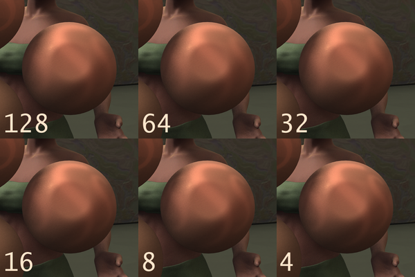

    Shading Rate is a quality setting. Unlike the Uber lights, higher values mean lower quality, less computation load, and faster renders. On this relatively simple image, the delta between rendering at 128 and rendering at 16 was only about a 2% increase in render time. Pushing to 4 took 11.5% longer than the render at 128. Visually, the higher quality translates to a smaller blur and more intensity in the SSS effect. The default of 32 is probably a good tradeoff point; I couldn't see a significant difference between the the renders at 16 and 4.
    1080 x 720 - 425K
    330 x 1800 - 32K

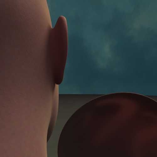

    The eagerly sought-after Ear Glow !
    Note that this is SSS alone, without any boost from Ambient. For my purposes, I rather prefer this approach.
    960 x 960 - 818K

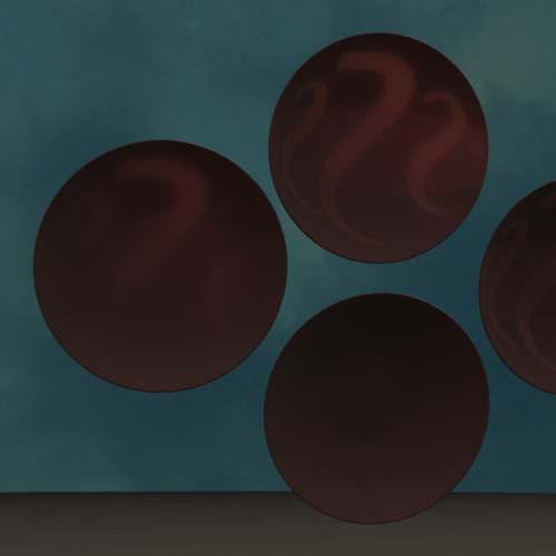

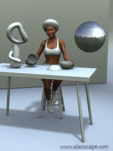

    Here's a look at the test bowls from the shady side, while Vicki takes a break. Topmost is SSS+Ambient; leftward, SSS alone; rightward, Ambient alone; bottom, none of the above.
    Note how the SSS by itself responds to the availability of light. Where that bowl's curvature causes a contour shadow on the outside, the glowy fuzzy SSS pattern on the inside fades out. The same occurs within the shadow cast by the top bowl.
    Ambient effects, on the other hand (bowl), glow regardless of whether light is hitting the surface or not. Also, they don't look very "scattered."
    Overall, if I'm faking an effect of scattered light, I'd prefer that the method pay attention to how much light is available. When the lighting of a scene is bright and sunny with loads of ambient light from all directions, the Ambient substitute will do, provided the SSS map is already fuzzy. When the lighting is more chiaroscuro, it looks like I'll be tuning the SSS effect to be sure it's perceptible.
    Still have to figure out how to produce an exaggerated waxwork effect within DS, though... ;-P
    960 x 960 - 764K

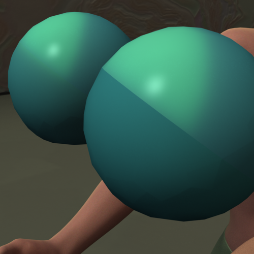

    Regarding grouping versus having to deal with textures/zones separately: As I read that thread, I don't think the Subsurface Group stuff is for helping me, as an end user, to manipulate a bunch of material zones as a unit. I think it's just a directive for the shader code, telling it to calculate some areas together, and some separately. ReDave's point about "no boundary between different material zones that belong to the same group" is a key concept, I believe.
    To test this idea, I'd set up two adjacent material zones in an object with the same general SSS settings, and place a bright area of SSS map in one of the zones, right next to the boundary.
    - If I assign both material zones to the same Subsurface Group, the SSS fuzzy glow should "bleed" across the boundary.
    - If I assign each zone to its own unique Subsurface Group, the SSS fuzzy glow should stop at the border.
    I'll go try this and post the results.
    On the glowy mouth syndrome: I vaguely recall stumbling into this in early efforts, but I didn't pay much attention--- I think I just set the mouthparts' shaders back to "DAZ Studio Default" and carried on with whatever was occupying my interest at the time. If I can recreate this condition intentionally, I'll try your suggestion. Thanks!
    cheers
    Alan
  • edited December 1969
    Yep, that's how it works. :-)
    The bauble farther away from camera has both material zones assigned to the same Subsurface Group, while each material in the nearer bauble is assigned to its own separate Subsurface Group.
    I also varied the Diffuse color slightly, to make the boundary more distinguishable, and tweaked the (Basic Primary) Specular settings to taste. Apart from those and the SSS settings, everything else is at UberSurface default values--- mostly "Off," notably including Translucency and Ambient.
    960 x 960 - 817K

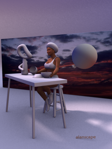

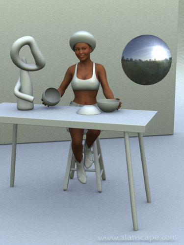

    Starter UberEnvironment 2 Lighting Rig . . . [Yay, new page!]
    First, a pointer to my favorite thread on the topic, adamr001's "Learning UberEnvironment 2..." Very useful.
    [EDIT] Also see a Dreamlight3D sample tutorial/introduction for UE2.
    Second, a quick textual run-through of some UE2 settings that would be typical of my usage. Your mileage will vary, you'll prioritize different attributes, and I'll even be adjusting them slightly/wildly as I work through test renders here. So stay flexible!
    Basic:
    Intensity - 100%
    Intensity Scale - 100% . . . . . . . For starters. This is a multiplier for the preceding attribute.
    (You might use this for a "noir" effect, to let you leave the first one bright enough so you can see
    your scene in the preview, and then dial this down so the actual render has darker shadows.)
    Color - [255 247 221] . . . . . . . . . I think I want to go just a smidgen warm with this light.
    & OmKitchen_EnvM.jpg . . . From DS4 Pro's Library\Runtime\textures\omnifreaker\Environment folder.
    Environment Mode - Occlusion w/Soft Shadows . . . A good middle choice. Nice effect, but not too computationally expensive.
    Map Controls:
    Saturation - 100%
    Contrast - 100% . . . Starting with defaults here. Similar to functions in an image editor, but here
    they're affecting the color and bright/dark areas of your ambient light pattern.
    This'll make more sense with demo images later.
    Ray Tracing:
    Occlusion Strength - 75% . . . . . . . . How intense or dark you want the Ambient Occlusion shadow effect to be.
    In most scenes I de-intensify it somewhat; this is a good starter value.
    Indirect Lighting Strength - 100% . . . Default. How strong you want the Indirect Lighting effect (bounce light) to be.
    Not used with the two "Ambient Occlusion" modes of UE2.
    [Above 2 notes edited after clarification from Szark-- thx!]
    Occlusion Color - [37 34 43] . . . . . . Something (ANYTHING!) other than that fleshtone-deadening pure black,
    in the Ambient Occlusion shadow effect. Purple is kinda classical. ;^D*
    Occlusion Samples - 96 . . . . . . . . . Affects quality; higher generally means less "freckling" in the A.O. shadows.

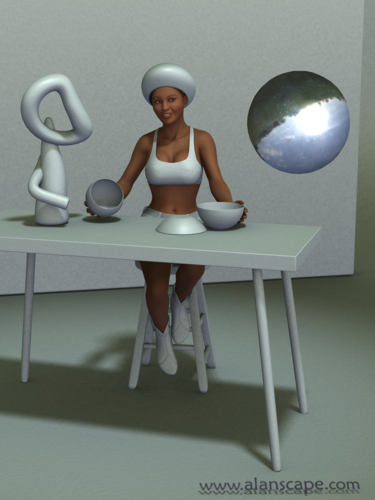

    Okay, so here's a render with just an UberEnvironment light active. I reused an existing scene, moved a few props around, added a couple of others, and then went through with a virtual spraypaint can, turning most of the surfaces off-white. For some reason, that last part was ridiculously fun...
    Changes to the settings quoted above, mostly for exaggerated effects:
    Turned the Intensity Scale down to 62.5%, to avoid an overexposed effect.
    The environment map is OmKHPark_EnvM.jpg, from the same location.
    (The kitchen didn't have much color variation--- brown floor, mostly.)
    Cranked the map Saturation up to 125%, to exaggerate the color of the simulated Ambient light.
    Turned Occlusion Strength down to 75%, for dimmer shadows.
    Turned Indirect Lighting Strength up to 125%, to exaggerate the color of the Ambient light. [Echo in here?]
    The thing hovering behind her left shoulder is the EnvironmentSphere, which loads in parented to the UberEnvironment2 light. Normally it's huge--- the idea being to show you the simulated environment that's bouncing all this light inward. Personally, I find it more useful to shrink it down and look at it from the outside--- that way, if I turn the UE2 light so that, say, a red area of this preview sphere is facing the camera, then I know that surfaces in the scene that are facing the camera will receive reddish ambient light. If I look at it from the inside, I'm looking at the light colors for stuff facing AWAY from the camera. Not as useful, IMO.
    It also took a bit of finagling to get the EnvironmentSphere to show up in the render--- it's set up not to. :)
    So anyway, if you click through to the (slightly) larger and (much) clearer original render, you can see that upward-facing surfaces are receiving blue ambient light from the virtual sky, while downward-facing (and sideways) surfaces are picking up the green of the virtual lawn.
    Next test (probably tomorrow): add an ordinary DAZ Studio spotlight.
    Alan

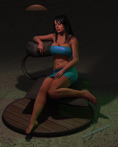

    Here's the scene with an overhead(-ish) spotlight switched on.
    The spotlight is using a cool [221 238 255] color, in keeping with the color scheme of the OmKHPark_EnvM.jpg environment map. Its intensity is a mere 37.5%, and the UE2 light's Intensity Scale multiplier is also lowered, to 50%. That's due to the fact that, on my first try, much of the white area was "blown out." Have I mentioned that there's a LOT of white area in this set? I still managed to blow out the highlights a bit on the second try--- however, that seemed to harmonize with the illicitly displayed EnvironmentSphere, so I left it like that.
    This is my go-to lighting rig--- an UberEnvironment2 set to do image-based Ambient Occlusion, plus one key light--- when starting to light a scene. From here, I can add elaborations, but this gets a big hunk of the heavy lifting done in a 3Delight render, for not much processing-time penalty. (And given the low probability of faster hardware in my immediate future, this is significant.) If you flip between this render and the previous one, you can see that the modeling (in the lighting sense of the word) of forms in the shadow areas is due to the UE2 light. Much nicer than an inky void under the tabletop. (Unless that's what the image calls for, of course.)
    Another UE2 tip that's perhaps overly obvious, but still worth mentioning: you can rotate the light, to change how the image-based simulated Ambient light falls on your scene. Here it's rotated -30 on the Y axis, to bring the sunny hotspot to the front. I'll be back with a quick demo render or two in a bit, to show what silliness this allows...
    720 x 960 - 864K

    Let's see... There's a dark green leafy canopy overhead, and a nearby swimming pool is reflecting some blue light upward. Yeah, that must be it... ;-P
    (UE2 rotations: X 90, Y -72, Z 120.)
    720 x 960 - 812K

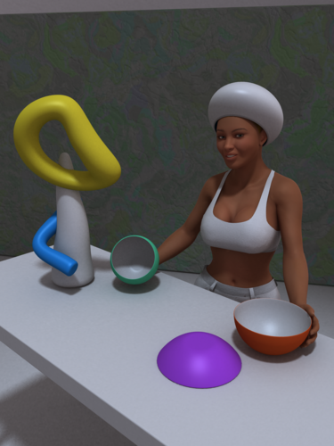

    Okay, I'll stop soon. :P
    Venturing perilously close to psychedelic territory, here are a couple of renders using the lighting setup from my contribution to the Halloween Freebies Challenge. Still one UE2 and one spotlight. The second one (if I've got my attachments in a row) is even shot through the same camera.
    Besides being silly, this also demonstrates how the surface settings affect the mood achievable by the lighting. All that clinical white is a lot less gothic than a dark-ish, heath-colored ground plane...
    The environment map image is OmCornellBox_EnvM.jpg; UE2 rotations are X -45, Y -54, and Z 18; Contrast (under Map Controls) is down to 75%; Occlusion Strength is up to 87.5%, for more intense (darker) occlusion shadows.
    720 x 960 - 834K
    720 x 960 - 788K

    I just did a rough, unscientific set of time trials--- being in the middle of accreting a new scene out of pieces of old ones, I had a reasonably simple (but not too simple) surreal jumble of props & one figure, with a fair number of surfaces occluding each other. So I did a series of quick renders, stepping the Occlusion Sample slider from 16 to 128, in increments of 16.
    Note that this left a bunch of variables uncontrolled, especially available memory as render windows piled up. On the other hand, they're small renders, and this situation is similar to my ordinary working conditions, so I'm not too concerned by this for a quick test.
    Times (approx): 46s ; 1m 1s ; 1m 19s ; 1m 31s ; 1m 47s ; 2m 2s ; 2m 17s ; 2m 34s
    Deltas (approx): 15s 18s 12s 16s 15s 15s 17s
    Despite that slight dip to a 12 seconds delta when going from 48 to 64, this is close enough to a linear progression that I feel comfortable in assuming that there's not a big hit (if any) using values that are not integer powers of 2. Heck, Omnifreaker could have programmed his shader/light code so this slider went in integers from 1 to 7, and then used those values as exponents. Since, however, the intermediate values were made available, I'm guessing that they're there to be used, if desired.
    A proper test would require trying many more scenes, preferably from multiple authors, and many more intermediate values. Which would be way beyond the scope of a series of posts based on, "Hey, here are some starter values that give me a reasonable result, so if you're stuck on UE2, or not even trying it, here's a place you can start, and then tweak settings to your own taste."
    So, I think I'll reinstate my 96, while keeping the new note beneath it. It's faster than 128, but still "de-freckled" enough, compared to 64, to allow me to judge how dark-to-medium-light surfaces (like skintones) are going to respond in a final render.
