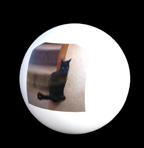

    Select the thing you want to apply the decal to, then go to Create>New Iray Decal node.
    With the decal selected, go to the Surfaces pane, select the decal's only surface, and apply the settings you want - here I just loaded a photo into the base colour.
    In Parameters set the Face mode - Front here - and position the decal. You can also use other Projection types, simple UV mappings in effect, and adjust the specifics of the projection angle and position in Parameters. The references for other software will probably be useful for understanding the parameters.

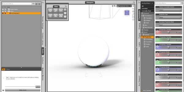

    Hi Richard
    I have at least now got the Decal to work but using a sphere, the image appears on the bottom. I have tried all the Nodes Projection Parameters to move the image but apart from a few weird reactions I can't seem to move the projection (Image attached
    1861 x 930 - 177K
  • Richard HaseltineRichard Haseltine Posts: 111,445
    It will project onto the area enclosed by the bounding box of the node, along the Z axis as far as i can tell (not sure how, or if, you can change that). So to put it on the front of the sphere remove any rotations, then translate it up and forward to enclose part of the front of the sphere.
    edited June 2015
    If it is a Studio generated primitive, what happens if you change the primary axis when generating the sphere?
    I don't have the 64-bit Iray enabled version installed where I can easily check...
    Post edited by mjc1016 on
  • stem_athomestem_athome Posts: 526
    This is a similar issue as with the ies lights, the decals default to z-up.
    I get the impression that who implemented this (and the ies lights) is either copying over scripts from 3ds max (which uses z-up world), or they do not know DS is using Y-up world.
