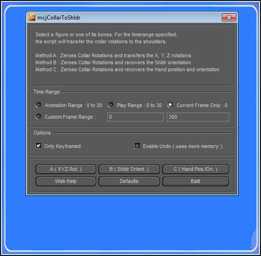

This script will attempt to Zero the Collar joint pose/animation
while maintaining the Arm pose
3 methods are offered
METHOD A : X, Y, Z (Euler) rotations transferred from Collar to Shldr after Zeroing the Collar Rotations
Method B : The Shldr Orientation ( Quaternion ) is recovered after zeroing Colar bone rotations
Method C - The Hand Position and Orientation is recovered after zeroing the Collar bone rotations,
if the shldr rotations did not allow it, then the Collar bone rotations are called back in action, though reduced

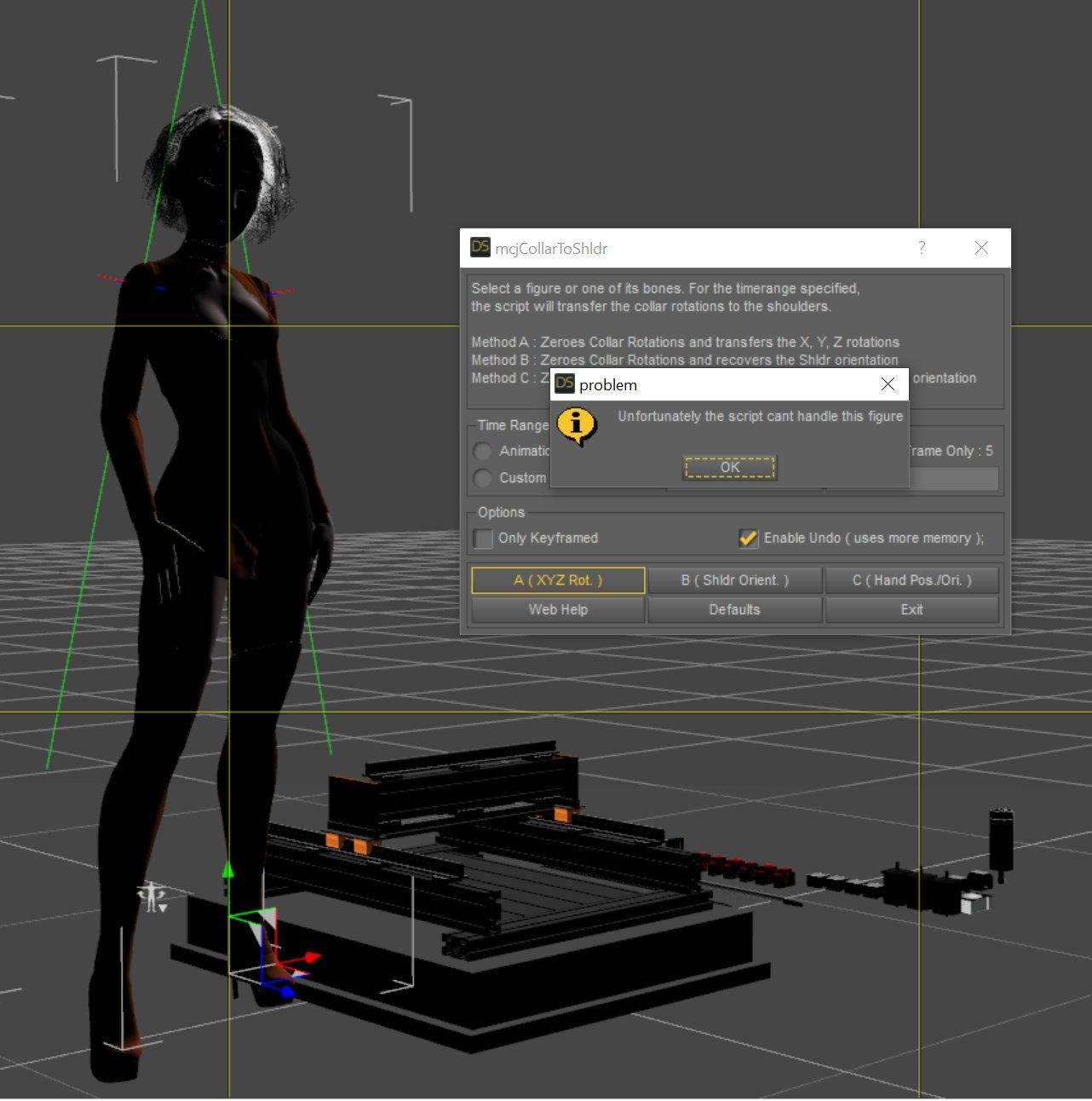

    Does anybody know if mcj-Collar-To-Shldr script works on G3 or G8 figures? I get and error message when I try to use it. I was hoping that this script might help resolve some of the lack of a twist bone problems encountered when importing a BVH converted from MMD. Wou
  • mCasualmCasual Posts: 4,607
    edited March 2021
    well it's a 2015 script and for now it doesnt support gen3 or gen8
    but at least it displays the message
    tomorrow i'll see if i can update it for gen3, 8 and maybe 2 and 1, though it probably supports 1 and 2, i forgot

    UPDATE GENESIS 3 and 8 Support
    March 16th 2021 - The script now handles the Genesis 3 and Genesis 8 figures split joints
    https://sites.google.com/site/mcasualsdazscripts5/mcjcollartoshldr
