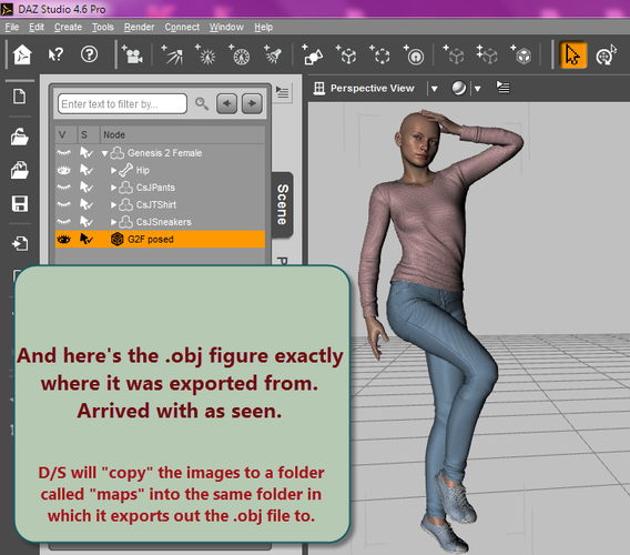

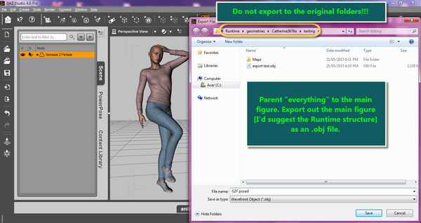

    1. Have the main figure with all the whatever "parented" to it, in exactly the position you want it to load. [can use the parameters tab to position to center].
    2. Have a folder ready, nested in the Runtime > geometries > YOUR name > whatever ... into which to export the new .obj files to. Why is because one has to keep the images together with the .obj file. This is to prevent them getting separated from each other as is likely to happen if one exports everything to a desktop.
    3. Select the main figure ... export it out as .obj file. Save to that Geometry folder you made for it. Use the "Poser" settings plus ONE change.
    COLLECT MAPS. D/S has to have the .mtl in the same folder as the .obj file AND the texture images in a nested folder IT MAKES called "Maps". I have attached pictures to illustrate.
