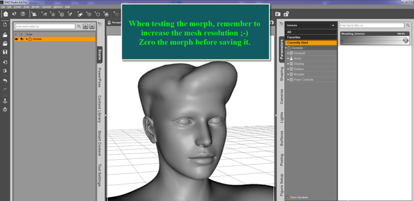

7: Ok the fun bit back in Daz Studio go to Edit>Figure>Morph Loader Pro now in there the Convert To Daz Studio From setting should be set to Daz Studio now go to Choose Morph File and select the modified file you exported from Sculptris and in the window below will be the name of the obj file you just created.. You can give the morph a name as well if you like for easier finding in Daz.. Click accept then ok and there ya have it you will find the morph under Morphs>Morph Loader in the parameters tab..
8: If happy with the results then go to File>Save As>Support Asset>Morph Asset when that window pops up give it a name in the product name if you want, then click the arrow next to the main figure in this case it is either Genesis 2 Female or Male and so on to expand the list once done that go down to morphs and click the arrow to expand that list then do the same with Morph Loader and you should see the name of the morph you just created tick just that box, click ok and you are done that morph should now stay there permanently in the parameters tab under the morph loader section..
Hope this little tutorial helps and makes sense since this is my first tutorial I have done.. Will add pictures at a later date but for now enjoy and thank you.. :)
Post edited by Ghosty12 on

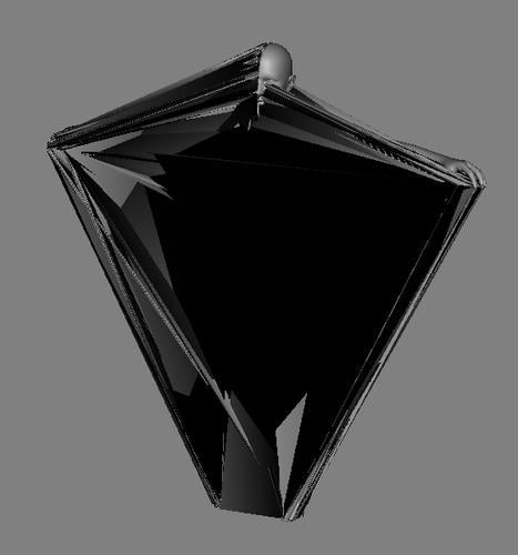

  • DaremoK3DaremoK3 Posts: 798
    edited April 2015
    This is interesting...
    ghostly12, it seems you are saying you have confirmation that the Sculptris symmetry issue (reordering of vertices on the mirrored half) is no longer present in Alpha6 with use of Genesis 2 figures.
    Could you please detail the variables for your working version (exact DS version, Sculptris A6 download year [they might have changed something and uploaded newer working version without updating A6 status]), so we can make sure to test with the right environment.
    Some of us have been using Sculptris since inception in 2009 by DrPetter in it's original incarnation (http://www.drpetter.se/project_sculpt.html) for morph targets, but there has always been an issue with symmetry (mirrored displacement). A lot of the threads are now defunct along with the old no-one-has-access-to forums, but an example thread in the current forums can be found here:
    http://www.daz3d.com/forums/discussion/1662/
    I mostly use Genesis (1), so I have yet to do any morph work for the G2's yet in any software, but I just did a quick test with Genesis and Sculptris A6 with symmetry turned on. The result was the same as it has been for years; Symmetry reordered the vertices on the (virtual) mirrored half which results in morph explosion. Result image below.
    My test system variables:
    DS 4.5.1.56 Pro 32bit
    Genesis 1 (Genesis Starter Essentials updated for that DS version)
    Sculptris A6 (2011 [version 3 according to the Config File])
    I'd be interested in using Sculptris again as a viable program for symmetrical morph targets, and would like to know if a new Sculptris re-download is in order, only the latest DS version can be used, or this will only work with G2 (latest Genesis 2 Starter Essentials). Would you please test with Genesis 1, and post your results here.
    Failed Genesis Symmetry morph:
    *EDIT: Good link with the issue, MegonNoel. I was writing well before your post (though times do not reflect), and Rogerbee's was the last post when I started (I know, I'm slow). I, too, moved on to Blender for most of my morphing work. Can't beat it's system (in my opinion) for morphing which includes sculpting, vertex displacement, and modifier displacement within a stacked slider module. Currently working on over 200 morph targets for a feather in a morphing arrow prop (yeah, that's just the feather alone).
    560 x 600 - 44K
    Post edited by DaremoK3 on

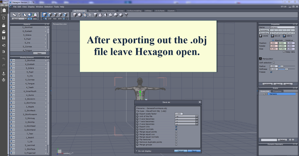

    One can use Sculptris to morph Genesis 1. I updated a tutorial and uploaded that about a month ago. In a zip folder at DA.
    The secret is to wash the .obj through Hexagon. Totally ignore what happens with the materials. Just use it to wash the .obj file, possibly fine tune some of the morphs from Sculptris, but I'd highly recommend shooting a morph attempt over to D/S first. After an .obj has been sent over the bridge from Hexagon, Hexagon must be "validated" in order to continue working in it.
    I also wrote up this for those that don't want to work through tutorials and the images are edited as I do for my tutorials many of which are used by a variety of folk with various learning situations so kindly disregard how presented if it bothers experts, not talking down to anybody.:
    3 programs:
    Start with D/S, send OVER the bridge to Hexagon, Genesis.
    Leave D/S OPEN.
    In Hexagon, export out the Genesis .obj as per attached image.
    Leave Hexagon OPEN.
    Import that into Sculptris.
    Morph it.
    Export it out.
    Import that into Hexagon.
    Rename the "default" .obj group to "Genesis".
    Delete the first Genesis.
    Select the morphed Genesis and send it back OVER the bridge to D/S.
    Make the morph.
    If like, SAVE the morph.
    Now, once the basics are done, back in Hexagon, VALIDATE.
    Then fix the morph some more if so desired, send it back over the bridge to D/S and check the options carefully. Either reverse morph or be sure to be sending it over to a basic Genesis figure to receive the full new morph.
    If like, SAVE the morph again.
    D/S always shoots out the base model for morphing over the bridge.
    On G2F with one of the creature HD morphs dials in, subdivision 3, it shot out G2F base with what appeared to be smoothing still added to Hexagon. In Sculptris I made a morph and eventually it landed back for creation in D/S. [have to reverse deformations not to double the creature morphs].
    D/S4.6
    Sculptris 6
    W7Pro
    1000 x 487 - 131K
    1000 x 521 - 163K
    Sigh, confirmed symmetry does not work with Genesis using the Hexie route either. Why is because apparently Genesis is not symmetrical so Sculptris changes a few things.
