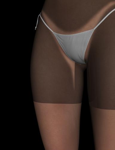

AoA's Subsurface Toon Shaders issues
IkyotoIkyoto Posts: 1,159
Loaded Genesis.
Applied V5 Bree texture, Nothing special
Applies STS Bikini.
Checked UV- Bree.
In all cases. ALWAYS does this
1000 x 1300 - 428K

    An overlay is going to be specific to a particular UV set. What UV set are you using instead when you uncheck the V5 set?

    v5 as product says. the only way it works is by using only the set as packaged.
  • Richard HaseltineRichard Haseltine Posts: 111,459
    What are the tan lines from? I thought Skin Builder but the pattern doesn't look like that, and anyway the Skin Builder tan lines seem to be working.

    I don't see anything in the on-line documentation, but on a quick test I think the overlays use the V4 mapping. You also, of course, need to use the same shader settings for the rest of the figure in order to avoid the abrupt change at the edge of the material zone.
