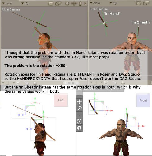

I've got a manual procedure (with a couple of scripts to assist) for positioning a hand-held prop in a proxy-hand at the world origin. The procedure is basically this:
1) Unparent the prop
2) Zero its translations
3) Zero its rotations
4) Zero its origin*
5) Zero its offsets*
6) Manually translate the prop to the origin
7) Zero its origin
8) Zero its offsets
9) Manually rotate the prop to the correct orientation
10) Record the translations and rotations
(*Note: the zero origin/offsets at (4) and (5) is mainly as a visual reference. (7) and (8) are for ensuring that rotations are about the world centre)
The result of this procedure is a set of six parameters (X, Y, Z rotations and X, Y, Z translations) that can be used along with another script to do the whole procress (1) to (9) automatically in the future.
For many props the six values I get doing this in Poser are the same as I get doing it in DAZ Studio (after converting translations between DAZ units and Poser units of course).
However, for some props I get very different values from Poser and DAZ Studio. I've just realized that the problem occurs when if the prop's local rotation axes aren't aligned with the world axes, since in DAZ Studio step (9) sets world axis rotations, whereas in Poser step (9) sets local axis rotations. At least that's how it looks to me - the attached screenshot should help visualize what I'm on about.
I'm trying to find a way of getting a set of three rotation values out of step (10) that will work in both Poser and DAZ Studio. Any thoughts and suggestions on the subject would be appreciated. I realize that the solution may be on either on the DAZ Studio side or on the Poser side, so I'm posting this on the a couple of forums.

    Trying to track this one down I've come across something I've never seen before...
    A prop (PP2) that loads in a completely different position in Poser and in DAZ Studio.
    I positioned the 'In Hand' M4 Journeyer Scout katana at the origin in Poser 6 using my procedure and scripts and saved it as a Poser prop.
    I restarted Poser 6, loaded M4 (just as a positional reference), loaded my new prop, and took a screenshot (also tried Poser 9 - okay too)
    Did the same in DS3. And then again in DS4.6 - both wrong.
    990 x 351 - 100K

    That PP2 basically has the following settings (all listed in X, Y, Z order here):
    OffsetA = (0,0,0)
    OffsetB = (0,0,0)
    Origin = (0,0,0)
    Orientation = (63.95,-8.86,14.14)
    Rotations = (22.9, 75.9, -10)
    Translations = (0.57, 0.089, -0.38)
    Maybe I should try editing the PP2 and setting Orientation to (0,0,0) to see if that puts the prop in the same position in Poser and DAZ Studio ?
    (I love trial and error!)
  • 3dcheapskate3dcheapskate Posts: 2,728
    edited April 2015
    That was a good idea - now I think I'm getting somewhere !
    Left - Poser 6, Right - DAZ Studio 3
    (and yes indeed, if I save the correctly positioned 'InSheath' katana (which worked correctly in both Poser and DAZ Studio) as a prop Orientation is already set to (0,0,0) in the PP2)
    So (hopefully) in conclusion I need to add an extra step to the procedure in my original post, something like
    "3a) Zero its orientation"
    816 x 293 - 51K
