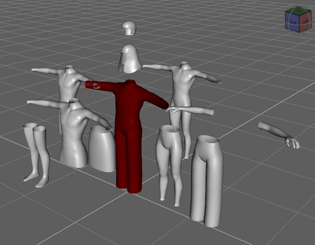

    From the sounds of things your trying to use Autofit to fit a Poser rigged conformer to a Tri-ax rigged figure other than Genesis, I'm still working on my Tri-ax converted Aiko 3 (rebuilding the morphs has been a nightmare) so I haven't looked to deeply into this. I think your figure will always show as "unsupported" as you don't need a "Clone" to help reshape the conformers, the “What type of item is it?” requires clothing/hair templates that are rigged and weight mapped to work with your figure, it's this rig & WM that gets transfered to the conformer, without them it's your figures rig & WM that is being transfered.
    The attached pic shows the templates for Genesis.
    775 x 604 - 202K

    The templates are just basic clothing/hair shapes, things like "quicksuits", they can even be modified parts of the figures own mesh, some of the ones for Genesis are like that, you just need to rig & WM them so they work well on your figure.
    Check in "My Library/data/DAZ 3D/Genesis/Base" and you'll find two folders called "Projection Templates" and "Tools", this is where they keep them for Genesis, the files in "Projection Templates" are the loader scripts, these are the exact same kind of files you see in the Content Library when you load clothing in to a scene, the files under "Tools" are the mesh, morph & UV files, and these are the same as the other DSF files you find in the data folder.

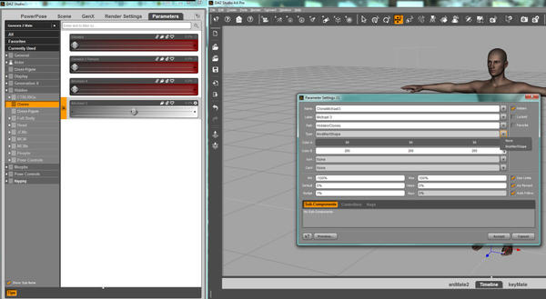

    I am attempting to make a clone of M3 for the Gn2 Male. Unfortunately, the only selections I have for "type" is modifier/shape or none. Is there some trick to it? Do I have to have the morph placed somewhere special on import? I have found most editing of files to be extremely frustrating in Daz Studio. Especially when most tutorials for sale don't include basic info...it is assumed that the basic knowledge is already known, lol.
    936 x 514 - 146K
    Hi Vulcanis,
    There is a tutorial for creating a clone over at hivewive. It is for creating a V4 clone for Dawn but you could substitute your figures where appropriate and it should work.
