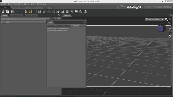

  • ImagoImago Posts: 5,782
    I just bought the plugin and the Gen2 extension.
    Installed, uninstalled and reinstalled many times... And still I get this error!
    This happen in both 4.7 General Release and 4.8 Beta.
    It don't work in any way!

  • edited June 2015
    Having same problem. Since updating to 4.8 public. GenX2 just won't work.
    I copied the Genx2.dll from C:\Program Files\DAZ 3D\DAZStudio4\plugins\ to C:\Users\Name\AppData\Roaming\DAZ 3D\Studio4\GenX2
    But when it boots up it just shows load figure. Before it would show Genesis and Genesis 2.
    Am I missing something else?
