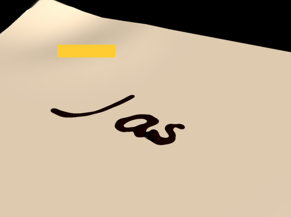

    Since my Carrara Monthly Challenge scene crashed mid-save, I've been experimenting with using a meta-ball emitter to spell a word for the fast animation challenge mmior started. Here's a screen shot. I should have the video up on youtube later and I will make the Carrara files available as well for those that want to experiment with the settings.
    637 x 476 - 42K
    Post edited by evilproducer on
  • RoygeeRoygee Posts: 2,247
    That's what I was looking to do - can't wait to see the settings :)

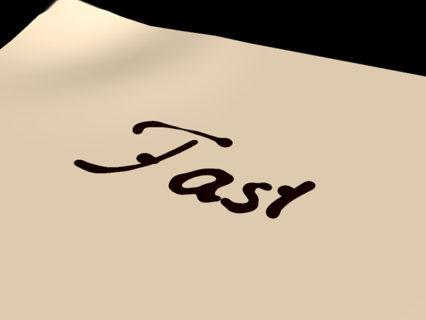

    I've been trying to refine the approach a bit. One more test render and that's all the time I will have for this scene.
    Been trying to lengthen the crosses on the "F" and "T." That's been my hold up so far.
    632 x 476 - 50K
    So, here's the Carrara files. There are two files. One with the image map I used as a template for using the emitters to write, and the second has the image map removed.
    Things you may want to look at for the emitters would be the number of particles, meta-ball influence and friction. Adjusting any of those may help with the look as the meta-ball are emitted. If none of those work, there are other settings to try, or you could use a writing implement to hide the emission point.
    I don't know what effect it had, if any, but I also changed the surface properties of the paper to have low bounce and high friction.
    https://dl.dropboxusercontent.com/u/7370483/emitter-writing.zip
